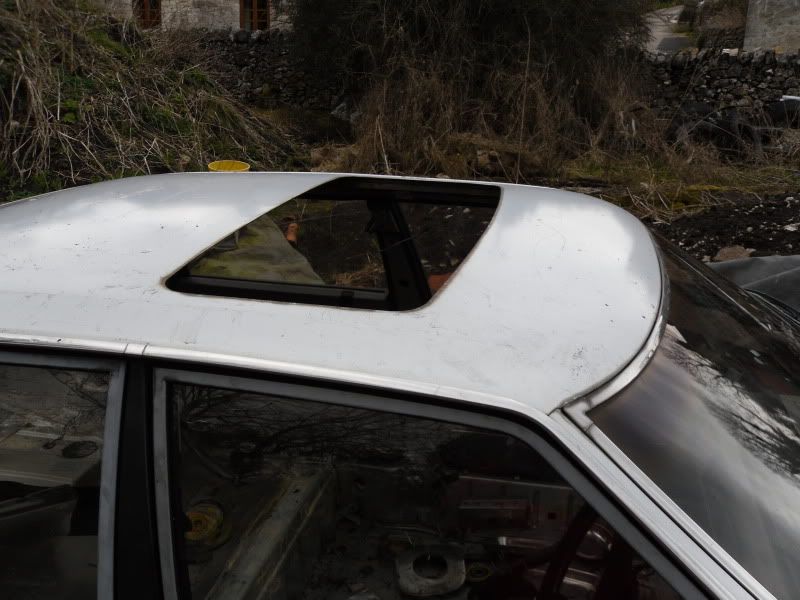

1985 Rover SD1 Vitesse, bought as a standard road car, roof replaced with a non-sunroof skin, full multi-point welded in cage, 6 linked rear end to my own design witha 4HA axle using a plate LSD and 4.57 CWP, Bilstien suspension front and rear and last but by no means least, the RV8 up front. I did start a thread about building an engine, and mine will have to stay at 3528cc, and cannot be forced induction, but hoping for somewhere in the region of 300bhp

That's gotta go....
Sometimes I can be quite "Roofless!"...i'll get me coat.....
