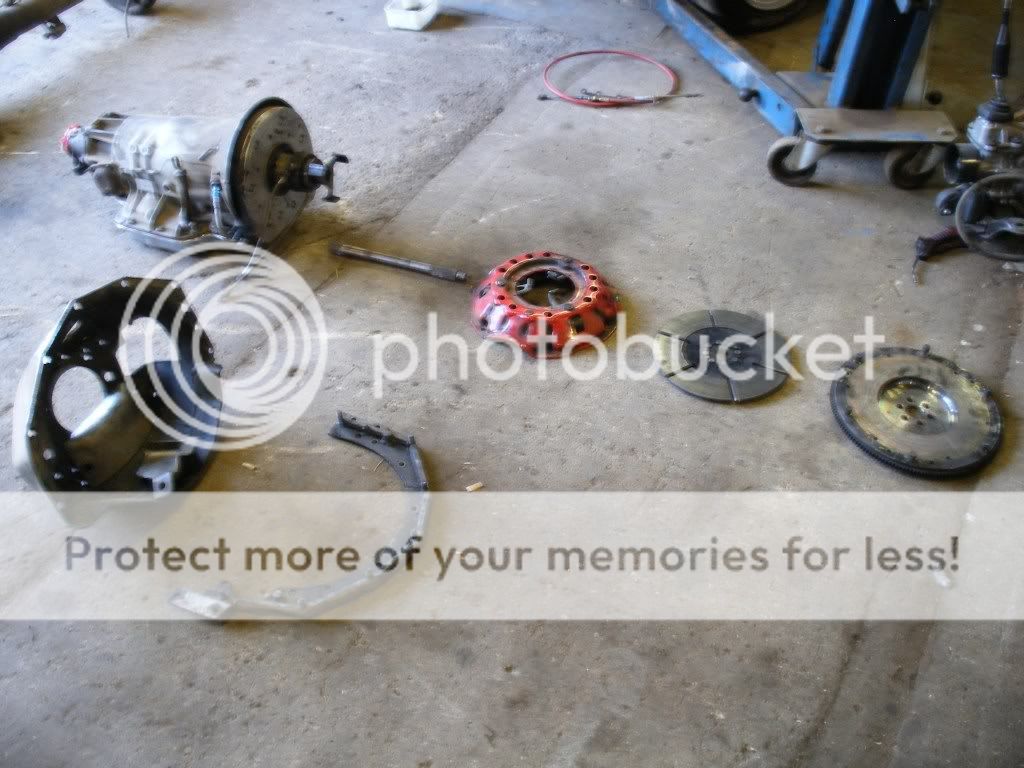

Hi all finally made up my mind
This is my new TH400 gearbox set up, Manual 1st and reverse with clutch operation auto 2nd and 3rd full manual shift,no torque converter,also bought a Ford 9"
If i can get all this in over winter and the roll cage should be able to put some BIG NOS shot through 300hp + ???
any advise or help more than welcome http://i705.photobucket.com/albums/ww59 ... box014.jpg
http://i705.photobucket.com/albums/ww59 ... tup001.jpg

the box looks abit special, , i dont have a clue how it works though . rich
Its a TH400 turbo clutch box made by a company called TCI, it came out
of a funny car good few years ago
then went into My mates Steve Good drag car Pulse Rate
If you look at the front of the box you will see a plate by the release bearing, this hooks it to the pressure plate and drives the oil pump in the gearbox.
Its all SFI drag race spec wont break this one
