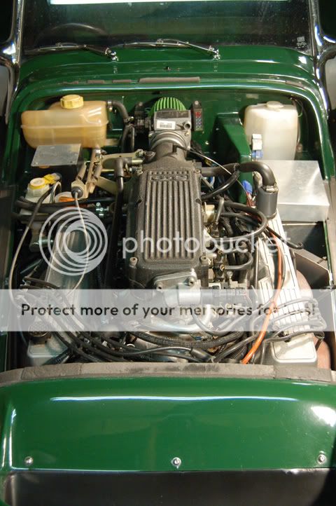

The reason to start posting is that I'm investigating the possibilities of upgrading the power plant. She currently has a 3.9EFI which apart from the K&N Air filter and a Mark Adams fuel map is bog standard.
Piccie of the current installation;
To be honest I'm a little past the initial investigation as I've bought the 5.0 bottom end of Mr. "V8 Jago". Though the project has many uncertainties I'm really looking forward to building the new engine. The aim for the new engine is between the 300 and 330 bhp mark.
