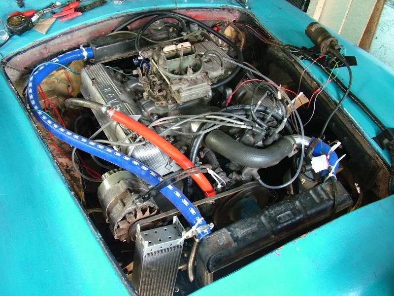

Been doing quite well with the engine fit, sitting in very nicely, just working on where everything will fit, the oil cooler, header tank, petrol filter, coil etc
Got spark at the plugs but the carb is in dire need of a rebuild, explosions aren't my thing !
May have found some exhaust manifolds that look like they'll fit... all going great
Stu

A mate had this rad which is a vast improvement on the original Vitesse rad:
The oil cooler is plumbed in, Rad plumbed in, electrics seem ok but still need to get a high torque starter due to the steering column and a decent battery, then I may actually get it up and running !

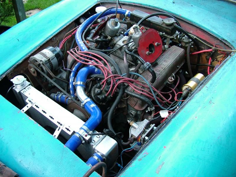

Update:
Engine as it currently is..
and decided to go Aero screen...
I did put this up for sale recently but came to my senses, I had a relapse with a back issue but its all good now thank goodness so no change to my fitness !
