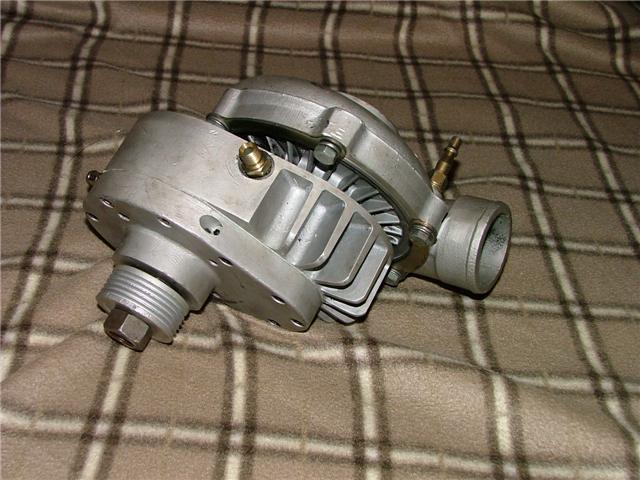

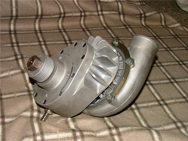

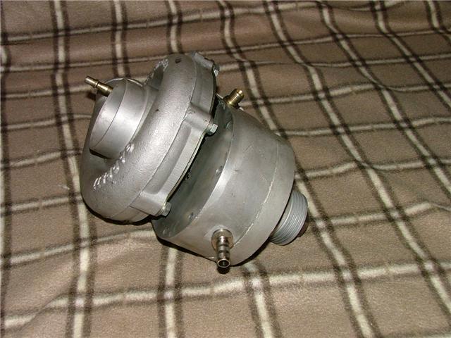

Been offered this charger, it seems to be home made, or i maybe wrong.
this ok for my 4.6 or not?
the internal ratio is 4.15:1

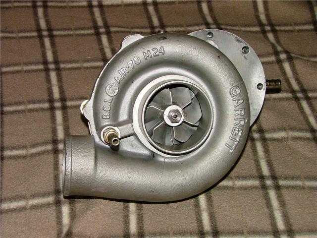

i'm told the housing and imppeller are from a GT35 turbo
the gears are straight cut
Hi Tony
I have a couple of concerns, firstly the size of the pully on the front, it is presumably that size to get it spinning fast enough, I think it may slip unless you can use a bigger one, that will mean a bigger bottom pully which could end up very big to get the necessary ratio. with the internal box ratio of 4.15:1 and say 2.5:1 on the pully, you will have it spinning at 72K revs at 7k on the engine. from what I remember turbo impellers run with boost from about 50k to 90 to 100k. I'll try and find the right map for this housing and it's flow against revs and see how it comes out.
Any ideas what it has run on before? what bottom pully it ran with and why it is being sold on.

What's the overall diameter?
I've found most centrifugal superchargers a lot larger than their turbocharger cousins. Because they generally turn slower. 50K - 60K.
Rotrex use a smaller housing which is more in line with turbo size but they turn a lot faster than the big Vortechs and Paxtons.
I don't recognise the gearbox.
I'm using a procharger C1. This also has a 4.7 ratio gearbox and the max impellor speed is 80,000rpm. I'll find out if it uses a straight cut gears?
http://www.procharger.com/models.shtml
Hi Tony
I have had a look at a couple of compressor maps for the GT35 .7 AR hosing, and provisionally I recon this doesn't have enough flow at low pressure ratio for what you want, I am assuming about 12 to 15 lbs of boost at 7k revs (to give you 3 to 4 lbs at 3.5k revs). I think it is intended to work with somthing requiring about 18 to 25 lb boost and about 2 to 2.5 litres capacity
If it is seriously cheep you could buy it for the gear box, get a bigger howsing and drive pully and Robert is your mothers brother!
he's asking £400 for it,
reason for sale he said its too big for his v6 rover 827.
Hi Tony
Having spent my time usefully at work today hunting around compressor maps and doing add-ups, I think this will produce the wrong combination of boost and flow for your engine, too much boost at too little flow. I would like a little more time to check my maths but I recon you want a T76 housing and compressor with an AR of .96 (this is the bit I need more information for and some more time to check my maths), assuming a starting point of that gearbox of a 4.15:1 ratio then you want to drive it with a toothed belt giving a further gaering up of 1.9 to 2.2:1 as I said before assuming you want to end up at about 12 to 15 lb boost at 7000 revs. you could try and use that one as it is but you would to limmit max revs to 6k and gear it up to 3:1+ on the belt, and drop the compression to about 8.5:1 otherwise it will over boost at 6K and still strangle the engine low down. He is right about the 2.7 engine, if he is not going for a high boost solution, it will give too much boost for that lump aswell as I posted earlier I recon it is intended for about 2 to 2.2 litres and 2 bar of boost.
Really it is only of use to you for the gearbox, and I recon if you have access to a mill and lathe you could make one up for less than £400 and you would then be able to buy a housing and impeller for a T76 and build your own (I would buy some helical cut gears for it if you are doing your own)
thanks for looking into it Mike,
looks like im gona hold back until i can find a proper one.
