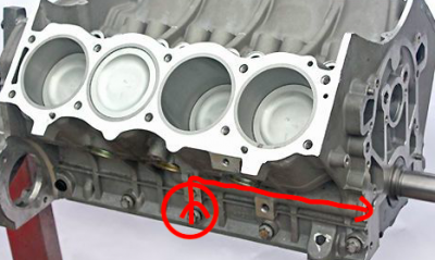

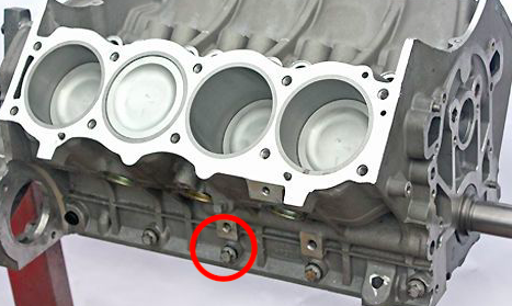

Anyone know the function of these (do they tap into the oil way?):
Building a westfield V8

Do not touch those - they are the cross bolts for the bearing caps and no they do not go into an oil way.

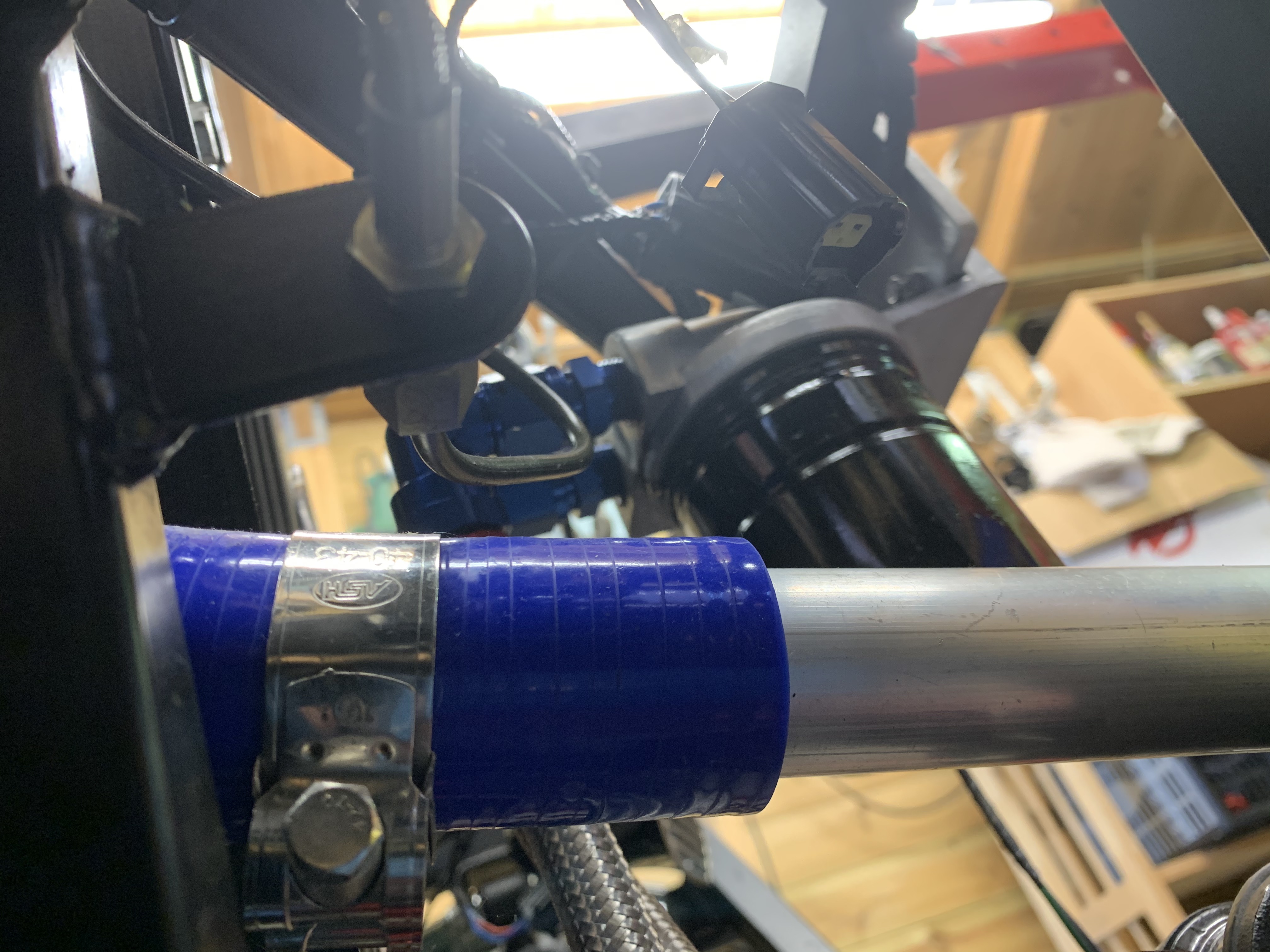

Oil cooler fitted ? Cooler hoses fitted the wrong way ?

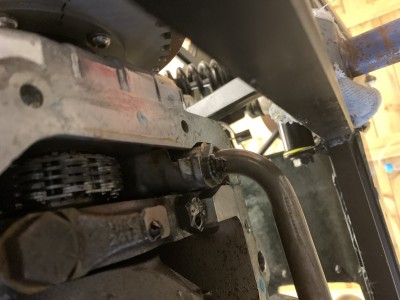

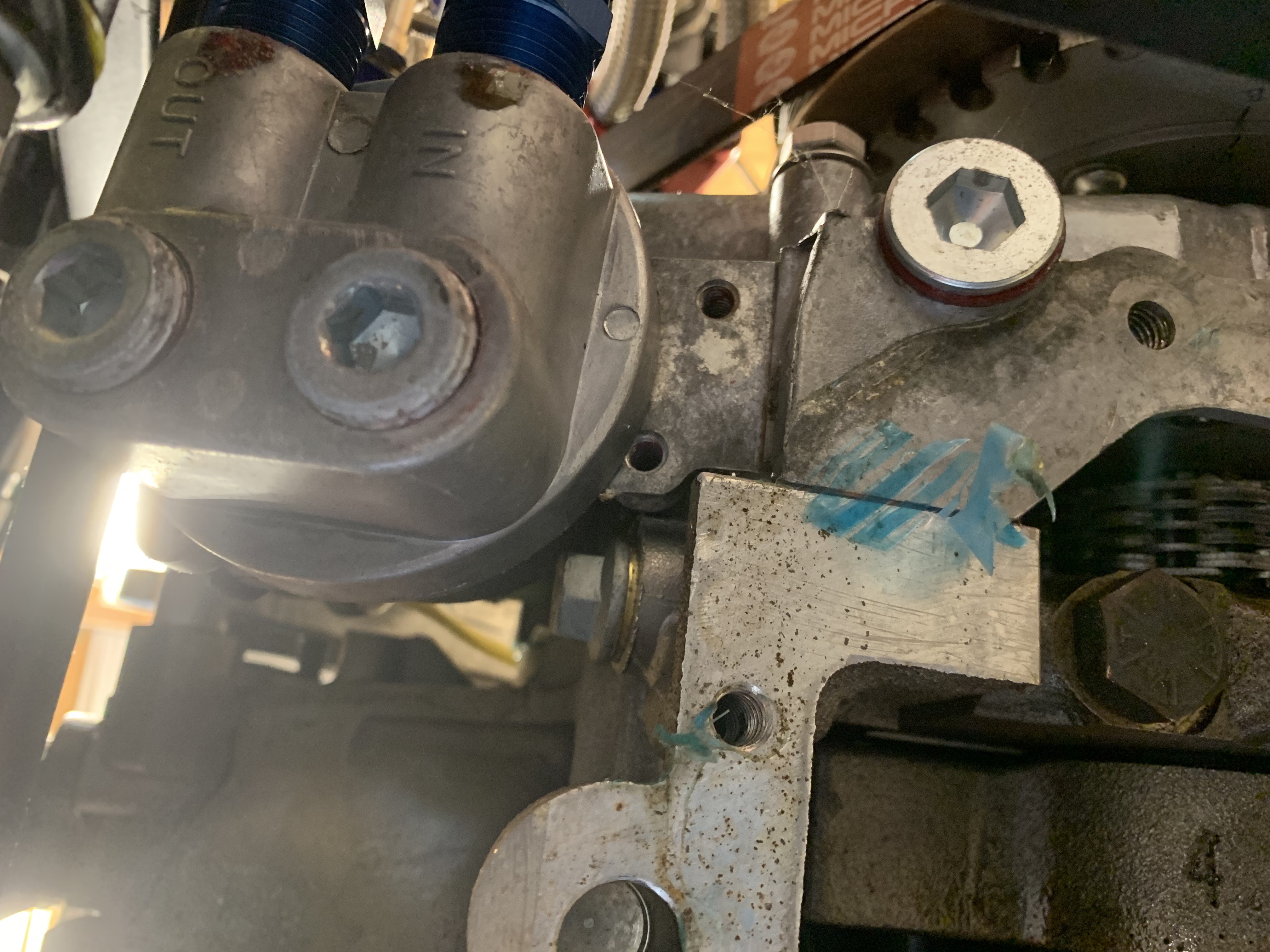

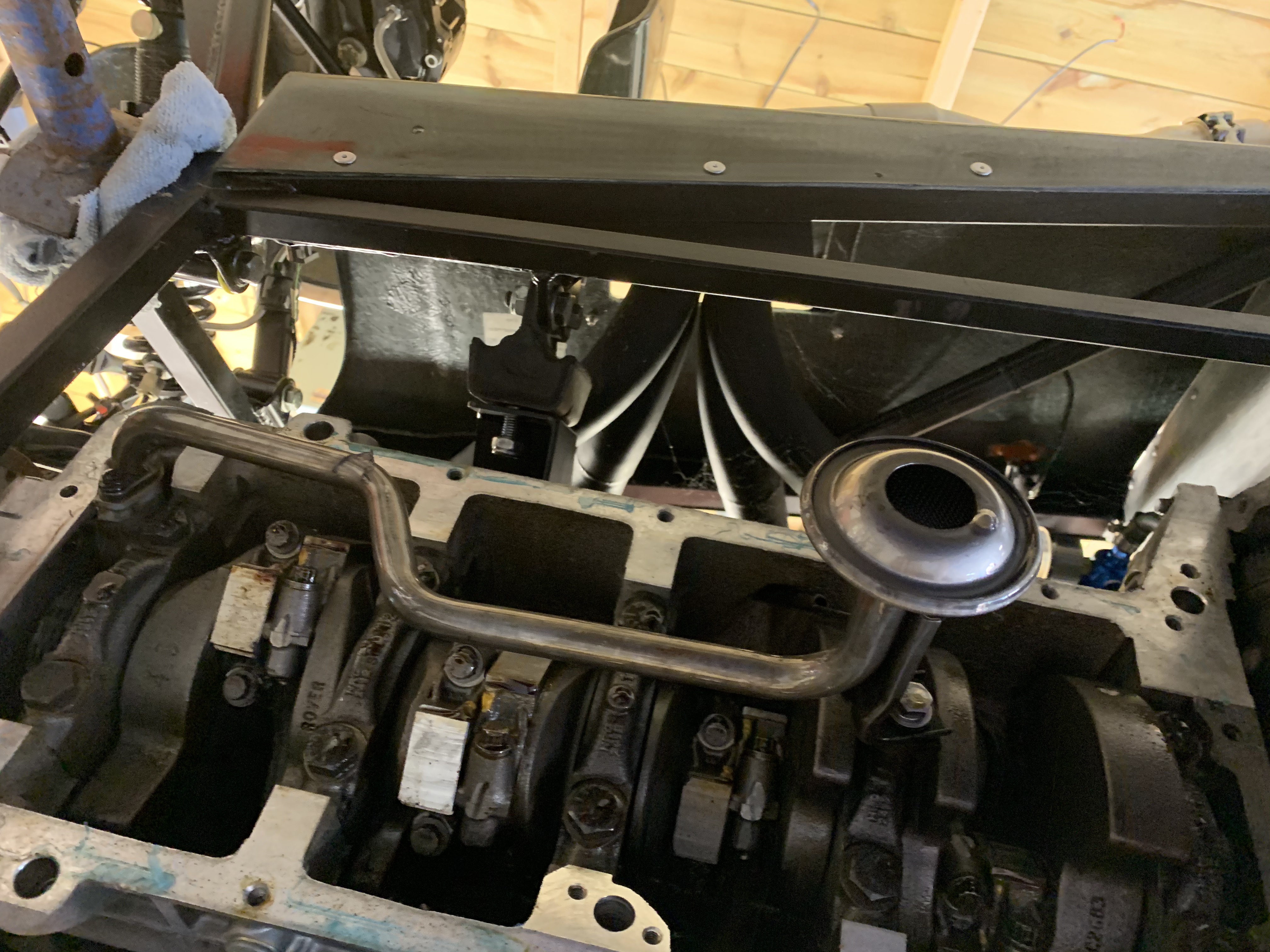

OK, thanks for all the replies thus far....I've checked the oil filter and it does have the rubber valve, but also this appears to be all going in the correct direction.....I have a remote oil filter set up, and the parts are labeled in and out, so its easy to see the oil flow direction. With plugs out I was able to really spin it around for quite a long time, and all done with the rocker cover off so I could see anything that resembled any oil coming through...nothing...dry apart from the engine lube I used when assembling the engine. oil light still on, no pressure registering on the gauge.

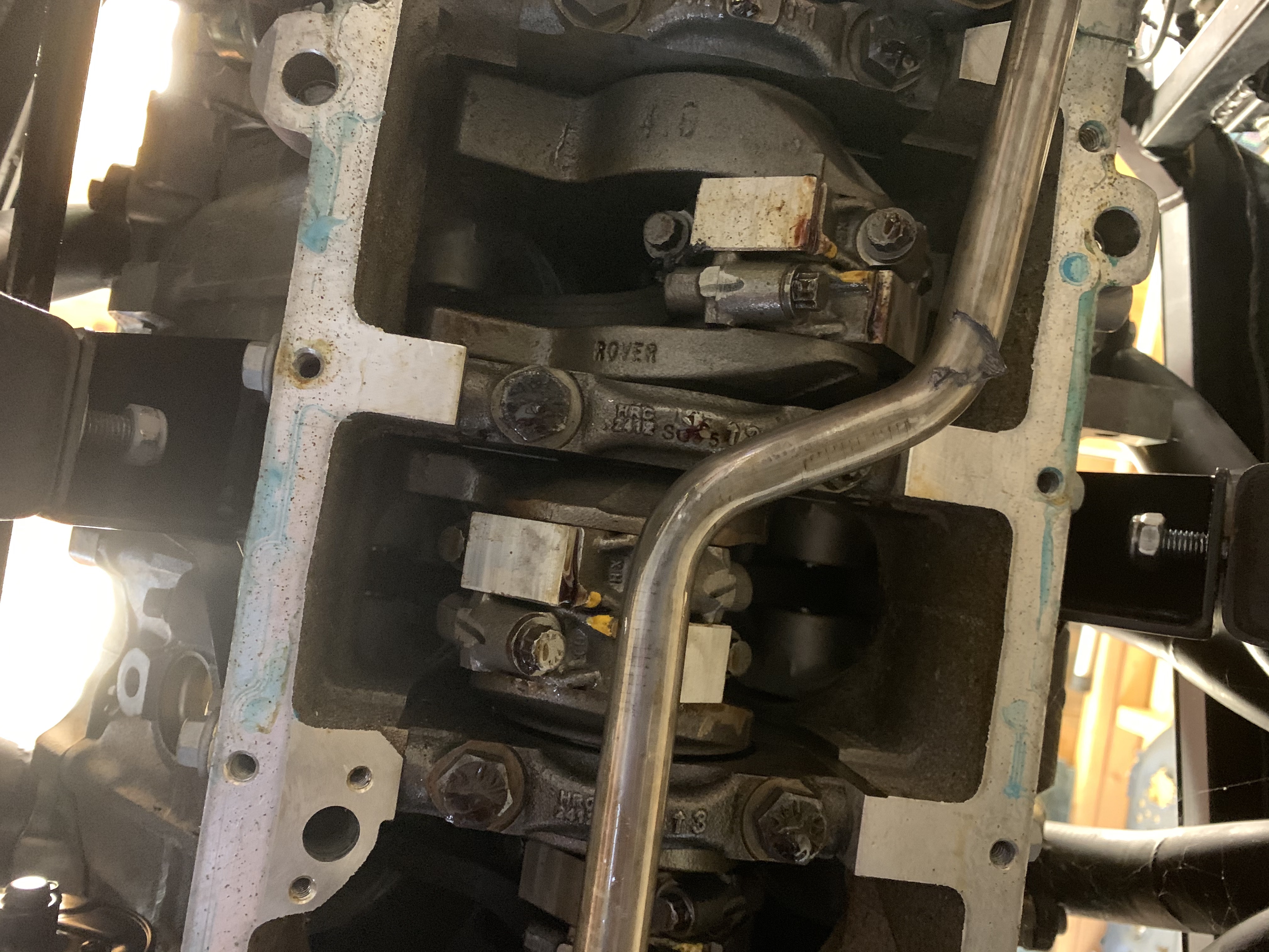

I've now taken the sump off, to jack the pick up pipe, and all seems well... also took some closer pics of the alternative older style pick up pipe location...it definitely goes into an oil way, but I think the front cover acts as a block to this.

This is where the other oil pick up goes....so the newer style front cover with the crank driven oil pump, must go over it to block it off.
So I feel like I'm back to square 1. I think the engine has spun enough times now that I really would expect to see oil in the engine. im stumped, next step is of course removing the oil pump. The only other thing I can think of is the remote oil filter 'in' 'out' tables are wrong!.
