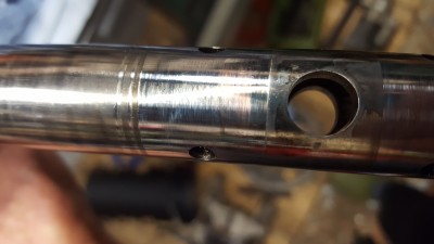

What clearance would be OK on the rocker shaft?
I can feel some ridges on mine. I'll measure up tomorrow and see, but rockers feel a bit rattely!
Replacement shafts seem pretty cheap but I have volvo rocker arms and I'm not sure where I can get them or if they can be rebushed?
Rocker shaft. Whats the max clearance?
Re: Rocker shaft. Whats the max clearance?
This is a volvo shaft as its 22mm.
I'm measuring 0.13mm clearance worst case, so they are a bit worn.
I would guess 0.05mm would be the right clearance?

It's a good question. I have no idea as each time I rebuild an engine, I buy new shafts and rockers as they are so cheap.
It means I have quite a few old rocker shafts though!

There are no figures in any of the Rover manuals that I have seen, they only tell you to inspect for wear, if any is present I guess that they expect you to replace them. I replaced my shafts and rockers, though the replacement rockers I got were steel rather than the expensive alloy ones.

I have no idea why this motor was built the way it was, but for some reason they went with adjustable volvo rockers and shaft. I doubt I'll find find new volvo rockers and shaft anywhere? Might just have to revert to stock, which means new pushrods and pedestals too...paul c wrote: ↑Mon Feb 07, 2022 7:02 pmThere are no figures in any of the Rover manuals that I have seen, they only tell you to inspect for wear, if any is present I guess that they expect you to replace them. I replaced my shafts and rockers, though the replacement rockers I got were steel rather than the expensive alloy ones.

This might be a useful thread, I had some issues a few years back with some cheap rockers being a very loose fit on the shaft.
