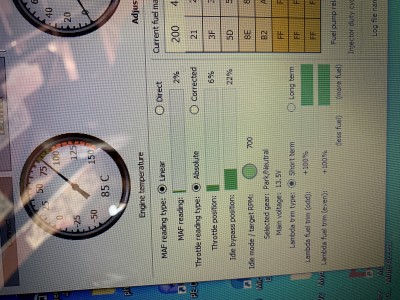

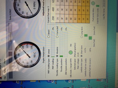

I have a 94 Morgan 3.9 injection with the 14CUX eco. it start and drives great but occasionally cuts out at idle. its been like this for about 18 months but its getting worse and not cuts out regularly.
I have rover gauge which had lead me down several false trails and I've fitted a variety of parts following 'advice' but the problem persists. I've fitted 3 stepper motors original, cheap Chinese and Britpart. The stalling continues. I've tried two MAFs original and eBay special (runs rough on this), still cuts out. I've set base idle, replaced fuel temp sensor (ouch!) and fitted new dissy cap leads and rotor arm (all from Morgan) and cleaned out the road speed sensor in the speedo cable.
Rover gauge points to this issues Stepper motor, speed sensor and error 69 NEUTRAL SWITCH. now I've eliminated stepper motor and speed sensor so Im left with the neutral switch which I understand on a manual is connected to ground via a 520 ohm resistor.

Tacho drops with engine not before, sometimes I can tell when its about happen as the idle hunts a little first, perhaps 1 maybe 2 seconds. More often it just stops as I'm approaching a junction with the clutch in can see the tech drop to 800rpm then as I come to a standstill it cuts out.

Don't know if this is your only problem but the section I've highlighted above is what you tend to get if the system is not getting a road speed reading, only just skim read the above posts (it's a bit late) so may have missed it but did you run the car with RG attached and if so were you getting a road speed reading? The reading doesn't have to be exact, but it does need to indicate when the car is moving. I believe TVR used a system which came in wtih a constant speed reading at about 3MPH basically telling the system "moving or not" and that still worked.Grumpy2 wrote: ↑Thu Apr 21, 2022 8:00 amyes it has the lambda sensors in the exhausts and a speed sensor in the speedo cable. don't know how to check fuel pressure although it had a new filter last year in an attempt to cure the problem
You may have come across this information
https://www.actproducts.co.uk/2011/luca ... tic-notes/
About 1/3 of the way down the page there is a section on the road speed sensor which explains why this may happen.
The Neutral signal to the 14CUX is a little odd as it adds an idle speed offset to the basic idle, typically about 100RPM so you may have a basic idle of 700RPM but when this signal is sensed it will rise to 800 or something similar. The strange thing is how this works (or why it exists) is the signal is when the gearbox is in neutral or park, in these conditions you get the higher idle speed which seems the opposite way to what I would have expected.
Obviously this is not important as you are using a manual box so you should have the 510ohm resistor permanently attached in this case you would get the offset RPM always in effect hence the higher idle speed.
I've actually made a modification to my system using a pressure switch on the clutch in place of the auto gearbox switch. In this case I get the elevated idle speed with the clutch pressed and the 100RPM lower speed when it is released, this means I can have a slower idle (and hopefully lower underbonnet temperature) when the car is sitting idling out of gear but a higher speed when I put it in gear to as an aid against stalling, particularly useful when reversing.
When the car is fully warm what does RG indicate as your target idle speed? Also what did you set your base idle to?
EDIT
I just looked at your screen grab, looks like you have a target idle of 700 (engine up to temp) and it's registering in park/neutral so presumably the gearbox switch is grounded and you are getting the basic idle speed (presumably 600) and the elevated idle combined.

Thanks for taking the time to reply. I have previously driven the car with RG connected and it does show road speed so I assume it’s working. Mind you I also assumed the 510 ohm resistor was in place as RG suggests but measuring with a dvm suggests otherwise.
