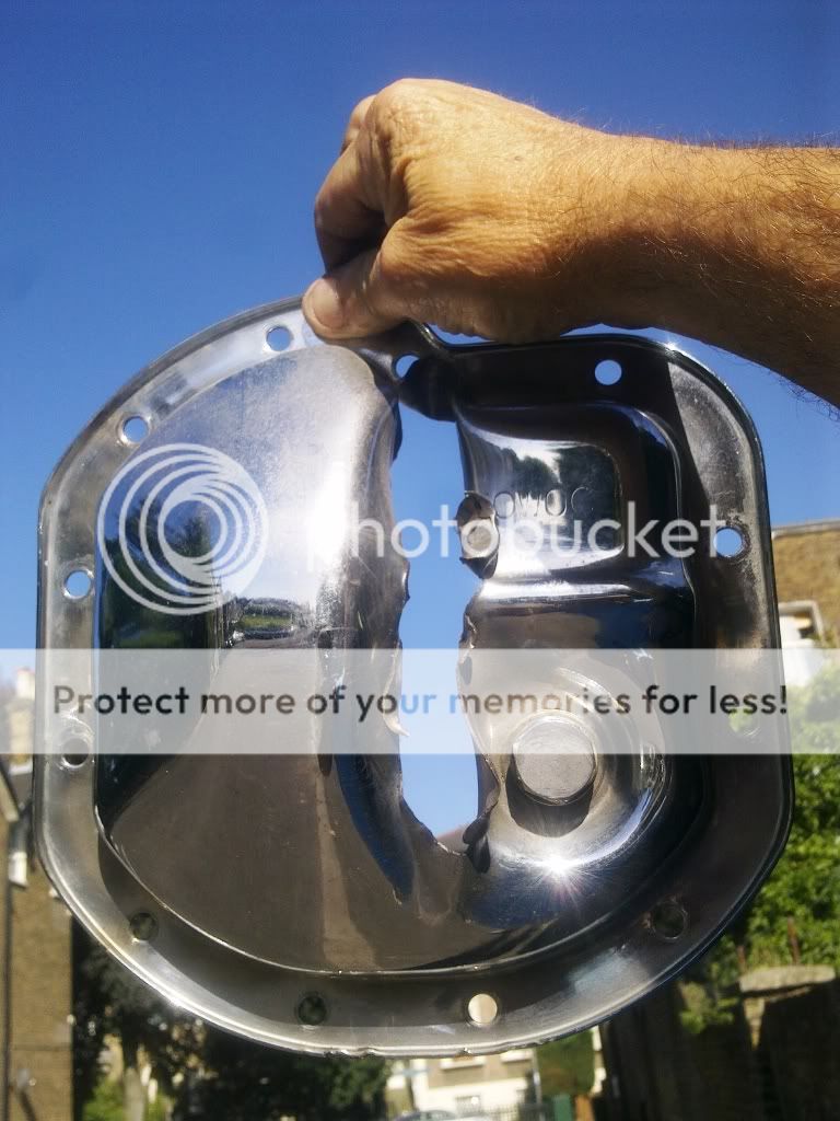

Re: MGB rear axle V8 and non V8?
Mine didnt !-------v8trev wrote:Will a rear axle from an 1800cc MGB cope with the power from a Rover V8 ?
(I realise the ratios are different)
Thanks for your thoughts
