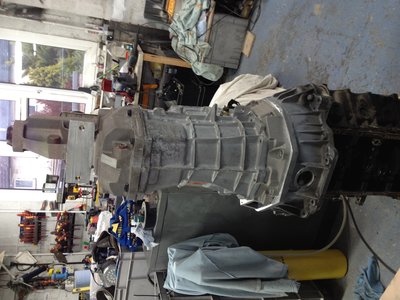

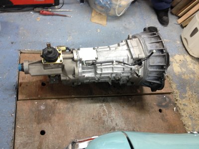

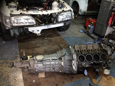

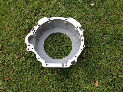

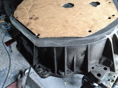

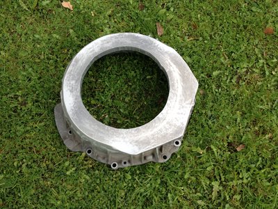

Just a few pictures of the progress.

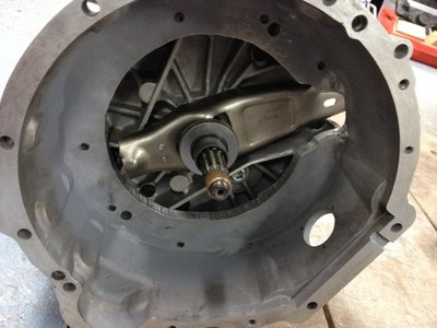

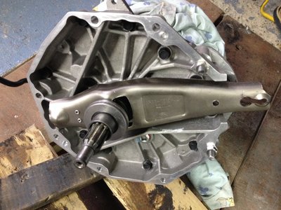

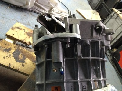

Basically a chopped down Range Rover bell housing welded to a 20mm ali plate drilled and tapped for the T56 Box. A slave cylinder is added outside box to push the release arm forwards. The clutch arm is shortened by about 2" (the bit that normally attaches to the cable and will now be pushed forwards by the slave cylinder threaded push rod.

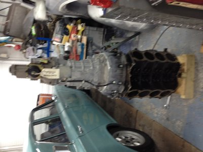

The box was temporarily mounted vertically on the plate/bellhousing (grease surfaces)and on a spare engine and using the prop yoke the pre mounting drag and post mounting drag was compared to get the best centralised position before drilling and tapping m10 bolts into the 20mm plate. Once the box was bolted down to the 20mm plate, 2 dowel holes were drilled and dowels fitted to ensure future location. Before everything was assembled the bellhousing /plate was skimmed parallel and then dial checked.

More pics

More pics. In the case of this Ford T56 box the new bell housing needed to be 129mm high to give correct engagement in the spigot bush. I don't like concentric release bearings so I have fitted a slave cylinder outside the box. The master cylinder is a Nascar pull type with max stroke 1" so a large 22mm bore cylinder is needed to get enough clutch bearing movement.

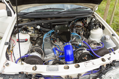

The Range Rover bell housing I used is quite bulky compared to others I could have used (lesson learnt) so to get more tunnel clearance I spaced the cross member down complete with engine mounts. I was also interested in getting a better prop angle and this helped by effectively reducing the tilt of the engine relative to the shell. A bonus is
that the complete unit with heads and turbos attached can now be installed & removed without jamming between the tunnel and the rack.
Just to add, when we previously fitted the v8 turbo we move the ABS control block to a position higher on the bulkhead to enable the 2.5" exhaust pipes to pass.

Thanks for the pic and info mate.
