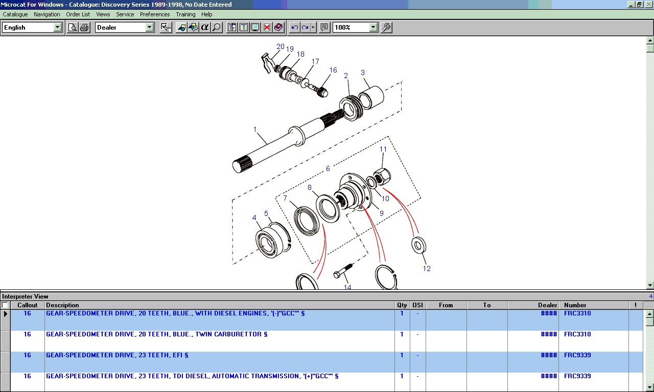

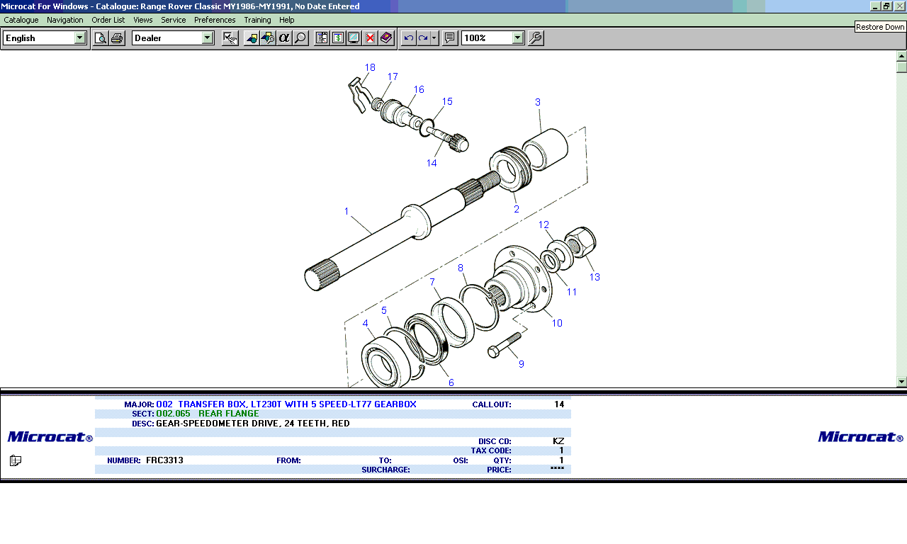

can anyone tell me the part number of the 21 tooth green drive gear please? Or even the 20 tooth orange gear? Preferably the Landrover part number. The Landrover with the LT77S gearbox still uses these same gears, even though the drive comes out of the transfer case. Is there an online website with parts diagrams/part numbers for Landrover parts?
Posts: 5078
OK. Here are three screenshots from MicroCat - the Land Rover Parts Catalogue. Apologies for their size!
Note that all are for 3.54:1 axle ratios.
Not sure if it helps!
