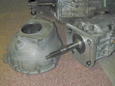

I'm currently doing this to change the gearbox from LT77 to ford cosworoth T5 in my v8 westfield.
I bought a TVR bellhousing, luckily from a nice chap on here, then worked out the differences in the input shaft housings then, removed this material manually, think it was 1-2mm all round so not had, marked it on with some digital calipers, then removed it with a large file, not hard but time consuming yes.....take your time...and a perfect fit.
I'm not using the bearing from the TVR or LT77, I'm using the tilton 60-6100 universal, which comes with a spacer you machine to the correct size of the outer diameter of the input shaft, it just then screws in the back, and slides on the input shaft, you then set the thread to give you 3mm gap between your clutch front cover and the bearing face.
I did also get the tilton master cylinder 75, as I was worried the girling one I had would alter the clutch pressure to much.
The tilton is so much easier to setup, and can easily be adjusted on the car, if the clutch wears.....
I have changed the crank spigot bush for the ford cosworth T5 one, which most TVR supplier sell, and I've have engine & gearbox together, dry assembled, and all looks good.
I originally bought an AP concentric bearing, but I would have to make a spacer for it to get the exact spacing between the clutch front cover, as the release bearing was the wrong type for my radius'd clutch cover fingers, and even AP themselves could not supply a flat face bearing to replace it, so £300 wasted......its now on ebay.
Gearbox is now in the car, I've made the speedo bank from some ally bar, installed the concentric pipework, and bleed screw, reversing light wired, and new T5 westfield propshaft.
Gear lever today, made my own, just need to work out a position place for the bend.
Hope some of this helps, but tilton do a range of concentric bearings for the T5's, just got to order them for America, mine was £350 from summit, with all taxes and delivery included, plus a 3 week wait of course.

The comments so far on this thread are based on the fact that the OP was fitting a Mustang T5 type gearbox in lieu of his LT77.
Fitting a Cosworth T5 presents a different number of challenges and it seems you have sorted those.
Out of interest did you check the run out of the hole in the bellhousing after your filing exercise. 10 thou max total recommended.
When I previously fitted a Cosworth box to a TVR bellhousing, machining the T5 bearing retainer in a lathe seemed to be the best solution.
For the Mustang T5 conversion the OP will need a special spigot bush, a different clutch plate (10 spline), source a suitable concentric, as there is less front to back space if using the Mustang T5 bearing retainer, and a special prop shaft with a mustang front yoke. The suggested swapping in a TVR bearing retainer makes the job easier and gives a more reliable clutch release system.
Hopefully he will find a TVR bellhousing in the near future.

wow you have got me worried now, that I've done something awful with my new gearbox install.....after watching those youtube vids.....it looks like i might have more problems.
But looking at the videos, its also how the bellhousing dowels locate the bellhousing to the block and the crank centre position.
Looks like it need to strip the bellhousing off the gearbox and check it before i go any further, the vid show offset dowels to correct and offsets.
Just hope these are available in the UK if needed.
more problems than answers........just when im thinking I'm getting somewhere its two steps back, my build is just problem after problem.

Seight-V8, Scott if you have filed out your bellhousing hole and its not 100% round getting off set dowels wont fix the problem, Rover size is 1/2 inch if you are going to buy them, you may be able to get some idea of how close you are and if you have a good fit to the gearbox bearing retainer/bellhousing you may well be OK but I would check your results from several different locations on the part you have opened out not just 12/3/6/9 oclock as most people do.

sorry but I don't want to hijack this thread, just to post an update.
I've been pretty worried after reading the replies and posts in this thread, but suppose I am glad it all came to light.
I stripped my bellhousing from the gearbox in the car this morning, and using a dti on the flywheel checked the alignment/runout of my bellhousing hole.
I think its turned out that my results have been really lucky....could have been much worse.
Results are in metric by the way.
Another weight off my mind for now at least.
