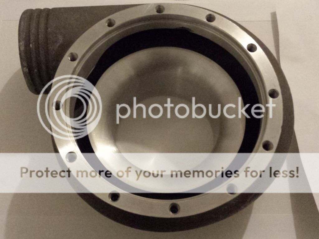

Had my new turbo compressor wheel machined and the house machined to match:

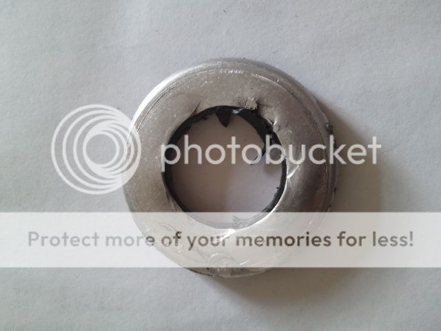

The old knackered seal
I have an SKF seal of the corret size but only 20m/s surface speed spec. At the moment i'm thinking of running with this and keeping a beady eye on the oil level.
