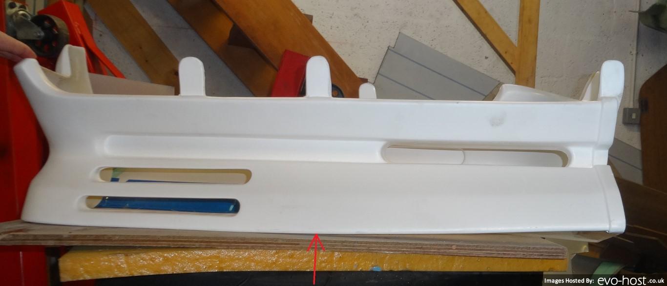

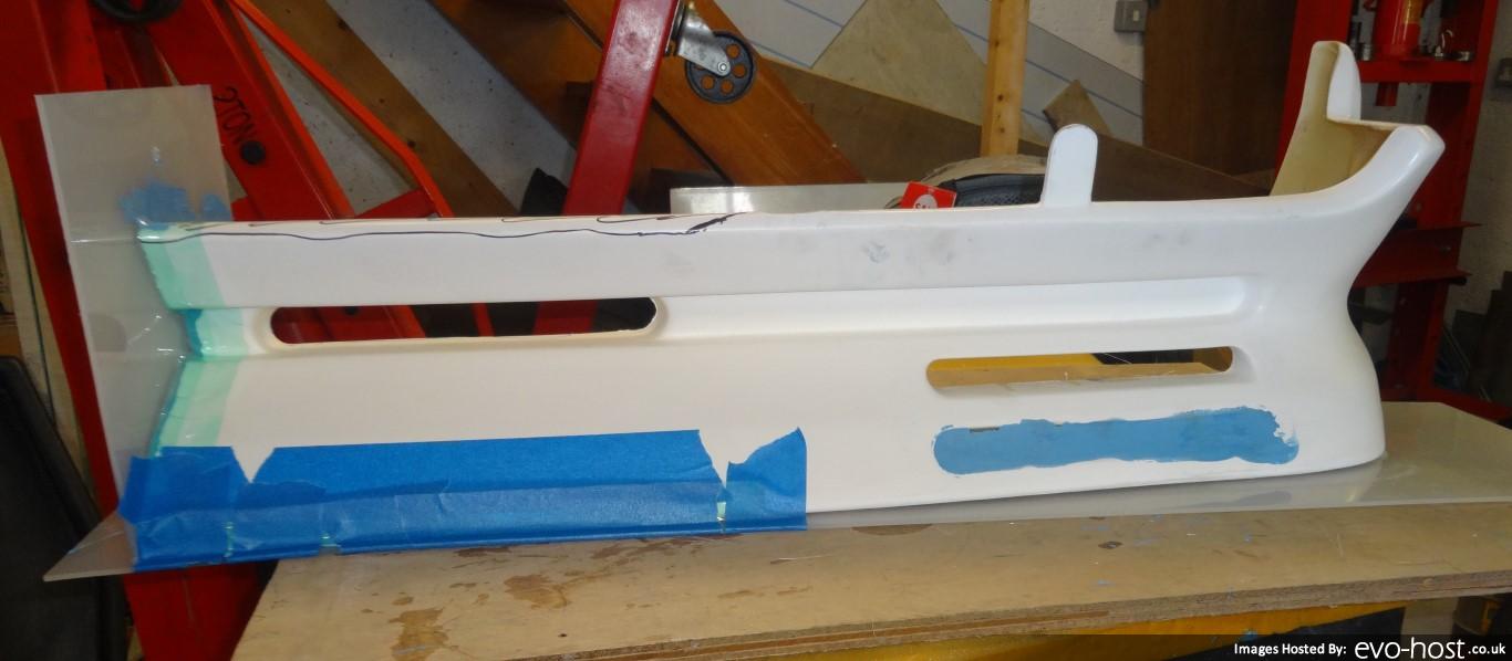

This is what I mean by oddly shaped. Spolier set on flat surface and I'd guess the entire base should be flat ?
It just looks wrong from the arrow to the centre of the car as if someone sat on it. Both halves are like that. Maybe it's supposed to, but it just looks wrong to me

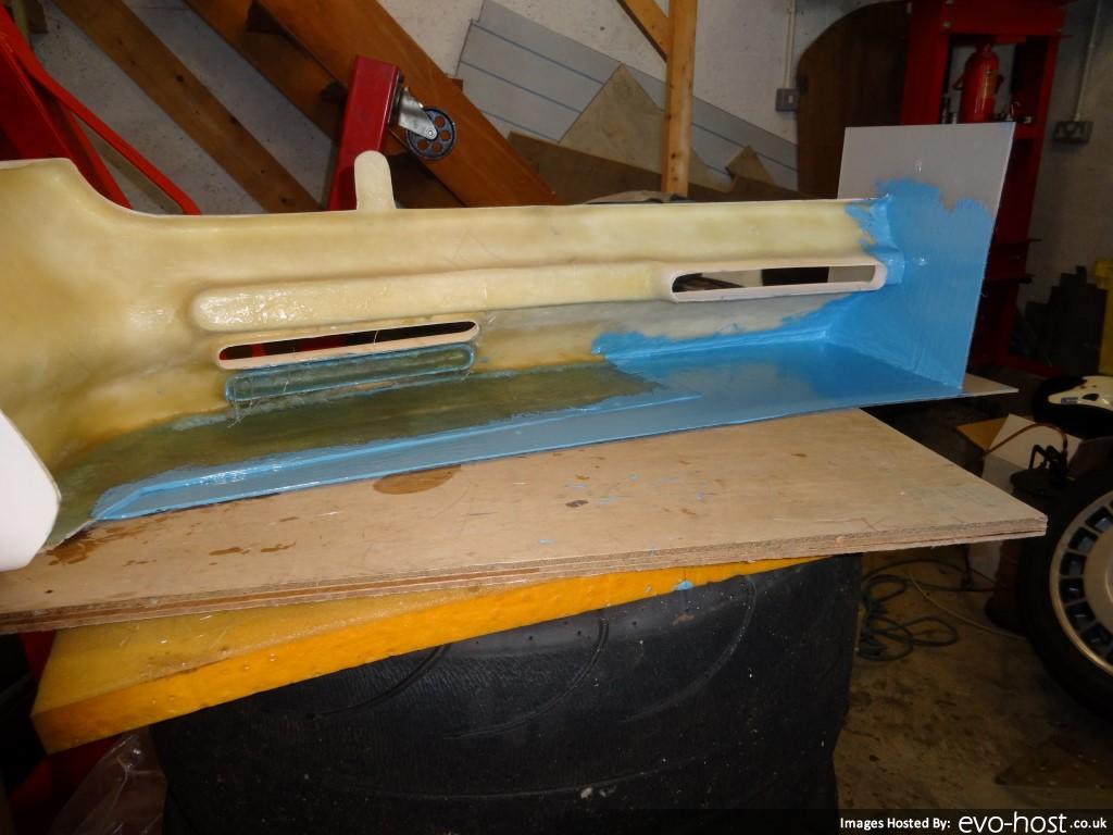

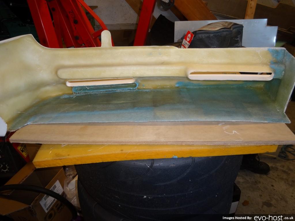

So, I've removed the reverse lip on the underside and I'm going to extend the leading edge downwards to the bottom is level over the entire width.
And also filled the lower of the air holes.
Then on the rear side I'm filling in a large flat base ( it was just a small return edge with this floating out front ) and creating a side flange so the two halves can bolt together easier.
I started on the base then decided I wanted to fix the leading edge hence base is partially done then cut away again
So I will now need to tuck the glass neatly into all those corners and contours where the new side flange is made.
Even on the flat base where it met the old return edge I got bubbles and the glass not sticking correctly to the shape. It isnt a big deal though as it isnt really a critical or finished piece.

Yea it's weird.
But I'm sure they sell loads of them...so surely their mould can't be screwed up or else other would be real bad ?
From various pictures online, it's just too hard to tell and maybe others have done repairs on theirs.
I just hope I'm not making an even bigger balls of it !! lol

Its looked to me with both sides being the same that the twist in the leading edge was part of the design - quite common to have that sort of profile and quite a few spoilers have a lift in the centre.
That looks to have a definite change in profile in the centre
And another - and have to say I quite like the profile

It may well be correct, I don't want mine like that though
and those are probably all from the same place anyway so if their mould was bad, everyones will be bad lol
Not sure if they're a copy of an RS part or if it's just an aftermarket thing.

I guess it's always worth checking...that if you're trying to straighten something...to ensure the piece of wood you'er using is also flat LOL...

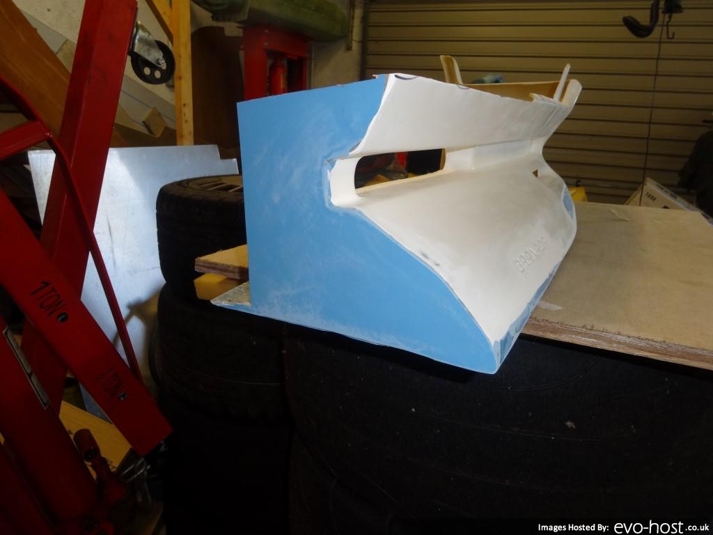

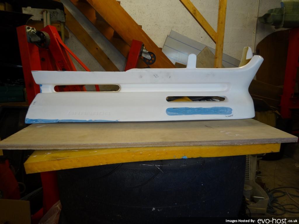

It's now got a little downturn in the middle pmsl, although not as bad as it was the other way. I only ust removed the tape etc to see how good/bad the shape was and gave it a quick sand. Needs some fillers etc but I think it's usable ok.
Needs another layer or so and then can trim it and try and fit it to one side of the car.
Rear
Side
Front...noting bent wood and the spolier now turns down a little lol
Will get some fillers during the week and fill the bits the gel coat didnt run into nicely. It was just the release tape as a mould so wasnt expecting it to be perfect.
Side and base turned out pretty decent which I'm happy about.
Rear
Side
