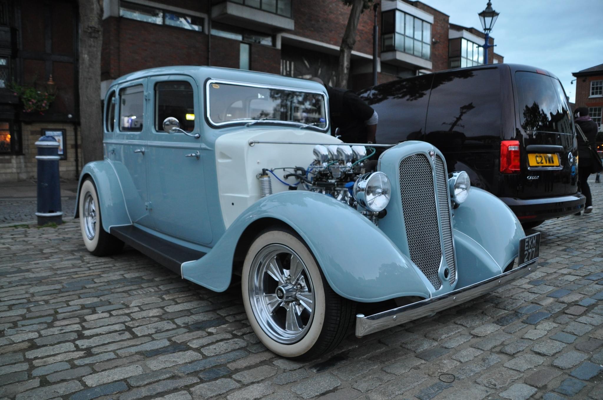

Here is my motor. I have been building the engine for about 3 months (collecting parts for as long as I can remember) It is a 1937 rover 10. It has a 4561cc Daimler Majestic Major Hemi V8. I have made the intake manifold to take 2 Stromberg 97's (2 are currently fitted). I am currently in the middle of adapting a ZF 4HP22 4 Spped Auto to the back. here goes:

Nice work mate & it's great to see an old Rover get rodded!! :D

Nice work, often wondered why more people dont use the 4.5 Daimler engine, it really is a loverly looking lump.
nice bit of welding on that bell housing and done well with those oil pump bolts
Have look at these, a guy fitting a Daimler to a spitfire using a six speed BMW manual box 8)
Another good example of jioning alloy to alloy 8)
You have a great looking car for sure
Cheers John

Been on the road 3 years now

Looks great! 8)
