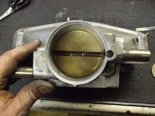

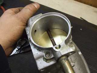

for my third ever milling machine project - i thought i would aim high and try boring out a rover plenum. After creating a few jigs i got it on the machine and bored it out without any problems. I couldn't get a 71mm plate so i made one from flat sheet, then turned it on the lathe.
Came out really well - i'm very pleased with myself. I think my old dad would of been proud.

Nice idea, when I fabricated my front entry plenum, I used a TB off a Vauxhall Senator/Monza, it was a ling time ago, but I think the bore was either 71 or72mm, plus it had the added advantage that it was a bolt on TB
Ian :D :D
THE SMOKING GNU
That's what i was going to do - so i thought i would have a go at machinng out - if it didn't work i would cut it off and weld something else on.
