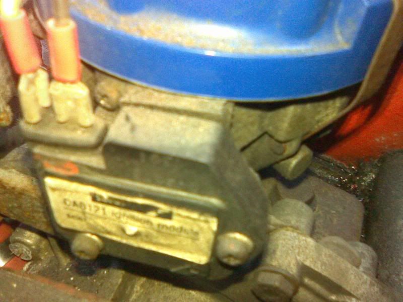

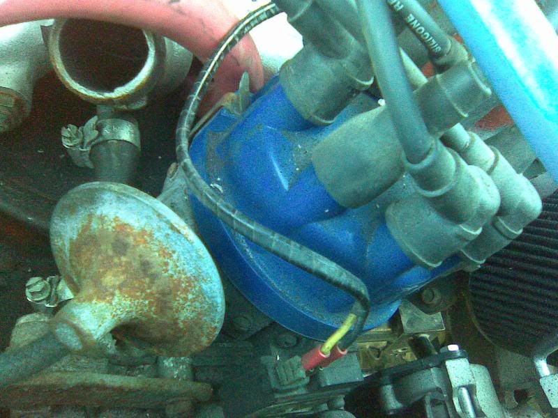

Hello Chris, thanks for the heads up, problem is I have already bought the new dizzy and its not exactly the same, MY BAD I know
heres a pic of the old one still on the vehicle
and the dizzy I have bought by mistake is this style (this is a library pic, my one is new)
35DLM8
does this meen it wont be compatible for me ? The engine is a TVR 350i
Thanks for your help
Holley
Posts: 5078
Not sure if it will fit, it most likely will. It looks like you have an SD1 style fitted to the engine, and you have bought a Range Rover style. This way around I think will be OK. Definitely fitting an SD1 type to a Range Rover engine is problematic.
The main thing to watch is the amount of adjustment you have by turning the distributor body. You might find that the vac advance unit or amplifier fouls on the water pump or rocker cover when you try to turn the distributor. You can work around it by removing the distributor and turning it one tooth on the camshaft, but it's all a bit fiddly!
