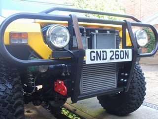

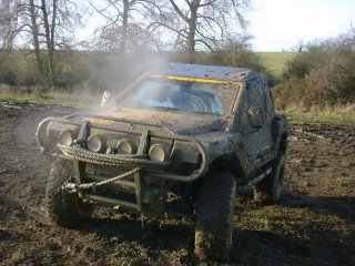

Some nice work there - but like others, I think they are going to really struggle.

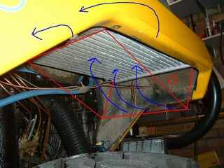

Have you considered boxing in the lower part of the intercooler then some duct work to draw air from the wheel wells?
Here's my musings when I had the same problem:
http://www.mez.co.uk/turbo8a-new.html
I run a pair of turbo's on a 5.7 in a range rover (Dakar kit) and had the same concerns - I went with a chargecooler initially:
(which is for sale)
But ultimately replaced it with a cheap Chinese FMIC, which is pretty tough and is easier to clean than the copper radiator(s):
However - I no longer do heavy off-roading, so i'm not concerned with blocking it up - because it would get blocked in that location, but then again the normal radiators get blocked which would stop play before a lack of intercooling is a problem - such as this:
If I ever do take it off-roading again, I would make a grill for the front and monitor air inlet temps.
(which is for sale)

Hi Eliot, thanks for your feedback, I actually referred to your work quite a bit in the early stages of design. I think taking the air from the bonnet would be the best area, but I may duct the air exits. Though it may get too congested in the engine bay!Eliot wrote:Some nice work there - but like others, I think they are going to really struggle.
Stirling
