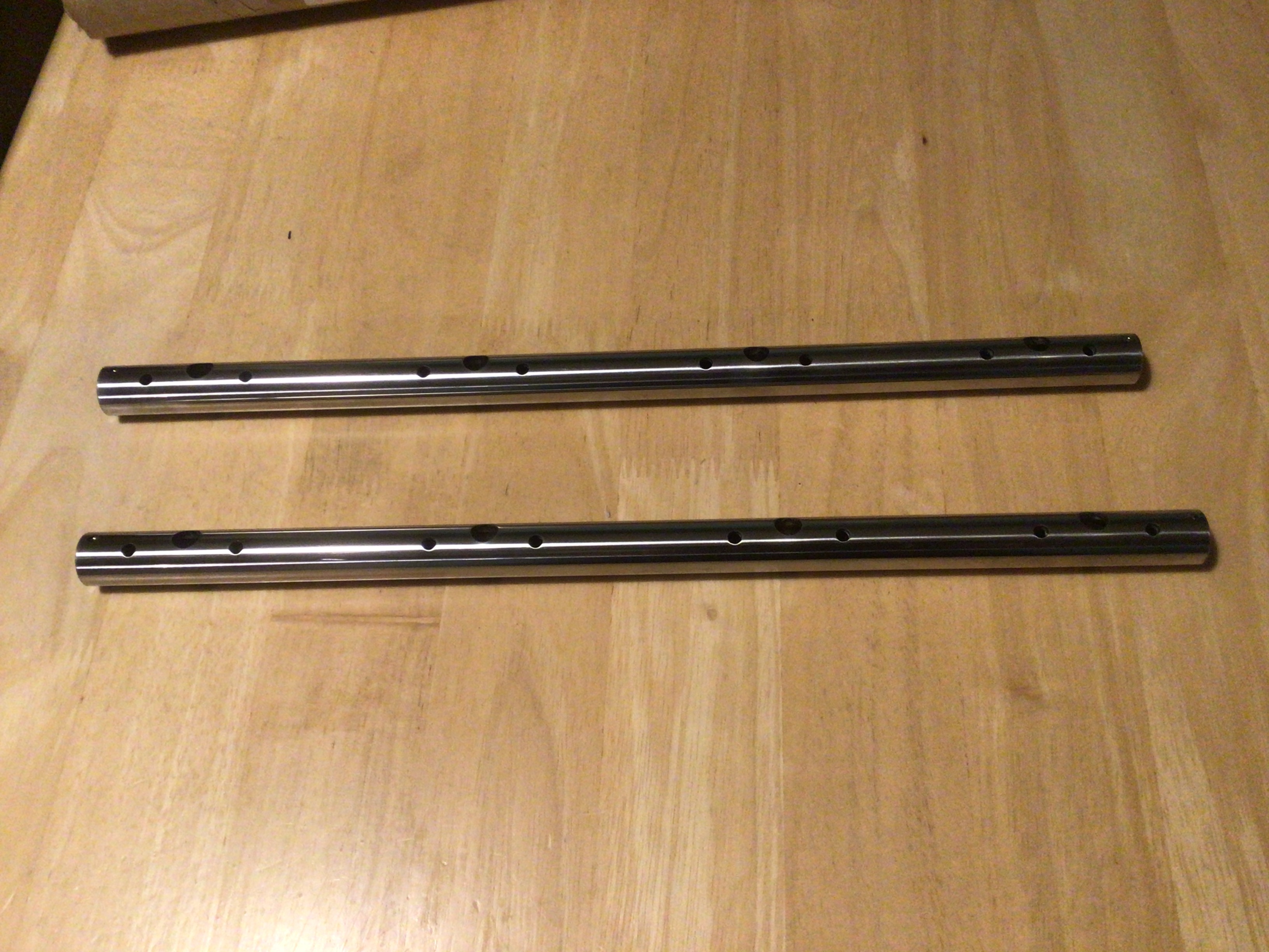

I made the decision to base the project around a 20mm shaft for the following reasons:
1. The original size shaft is not a standard industrial size that is easily sourced.
2. Keeping the standard diameter shaft would require too much material to be removed from the rocker to leave sufficient strength in the casting for insertion of a bronze bush. A 20mm shaft is a happy medium in these respects.
3. The next standard size down is 16mm (at least from the source I am using) which is rather narrow and could suffer from more flex.
I chose a quenched and tempered precision hollow shaft with minimum surface hardness of 60 HRC and drilled it to original specifications.

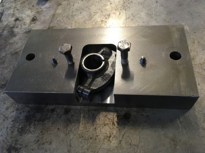

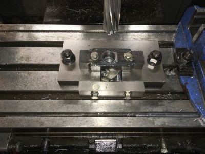

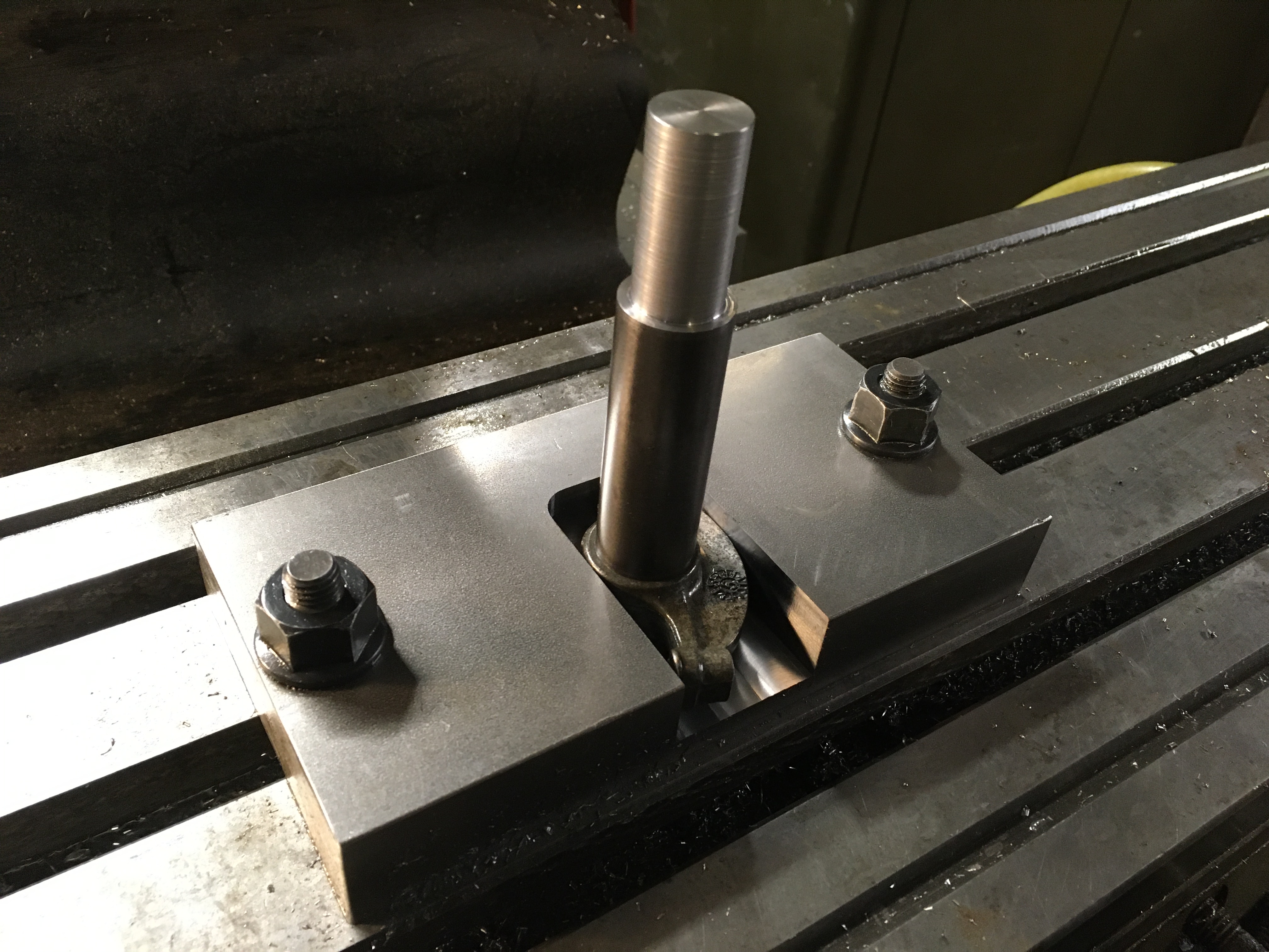

Next was to machine a mount into which the rockers can be placed securely so they can be first drilled to 22.5mm and then reamed to 22.98mm. I also machined a simple alignment tool so when the rocker is clamped the bed of the mill can be aligned with the spindle before machining the rocker. I utilised Land Rover flywheel dowel pins as locators to ensure I can repeatedly position the clamps accurately. Maybe overkill but it was fun.

Next job is to ream all the rockers. Currently half way through so pictures to come.
