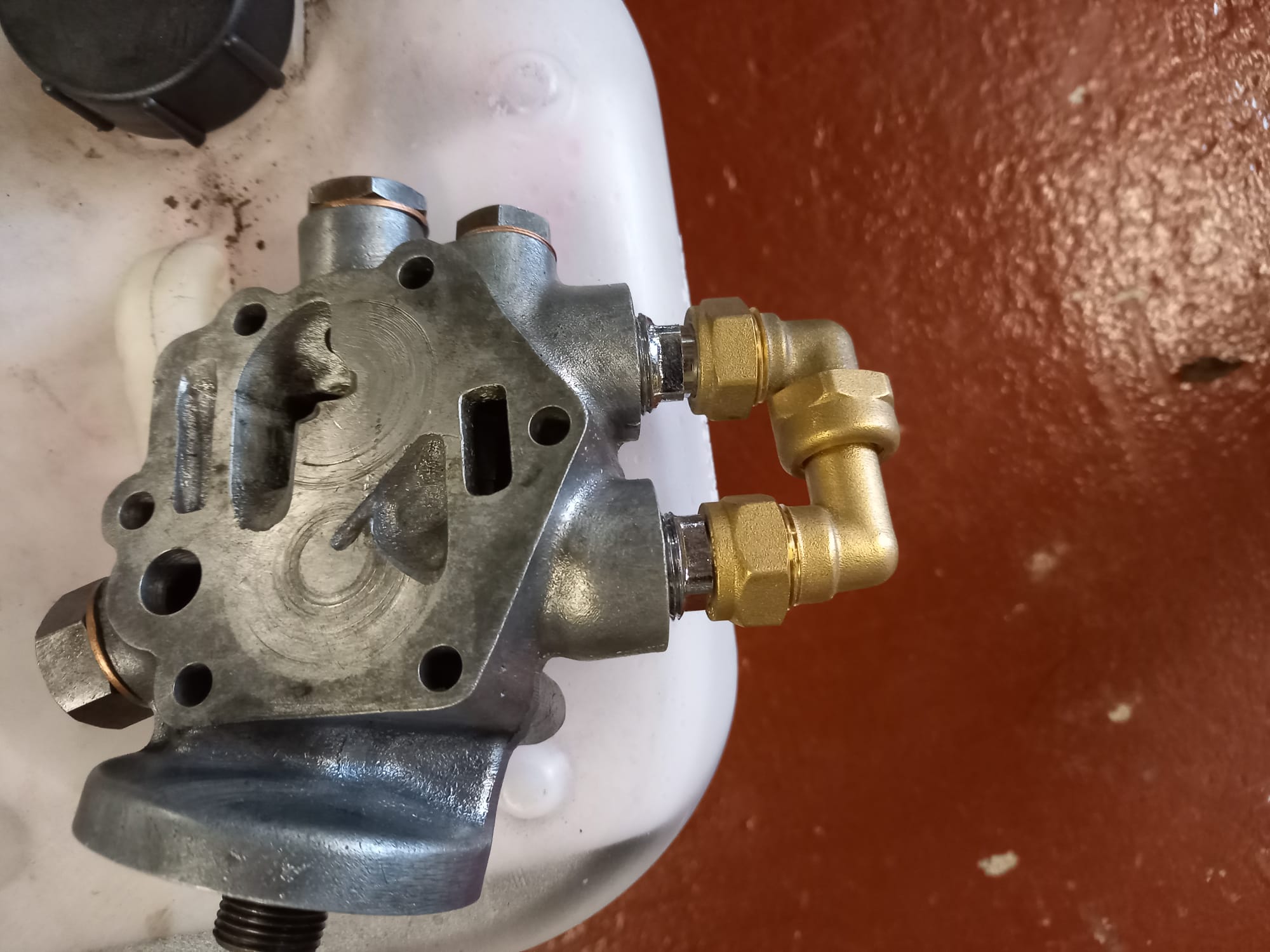

I've acquired a landrover 101 oil pump cover so I can reposition the oil filter to get clearance for a bigger radiator on my hotrod. The 101 pump cover has ports for oil cooler pipes and although currently blanked off I've been told I'll need to fit a bypass between the ports.
Has anyone done this and if so what size and type of fittings did you use and where did you get them?

An update for anyone in a similar position. 2 domestic radiator tails, a 90 elbow and a 90 tap connector, job done.

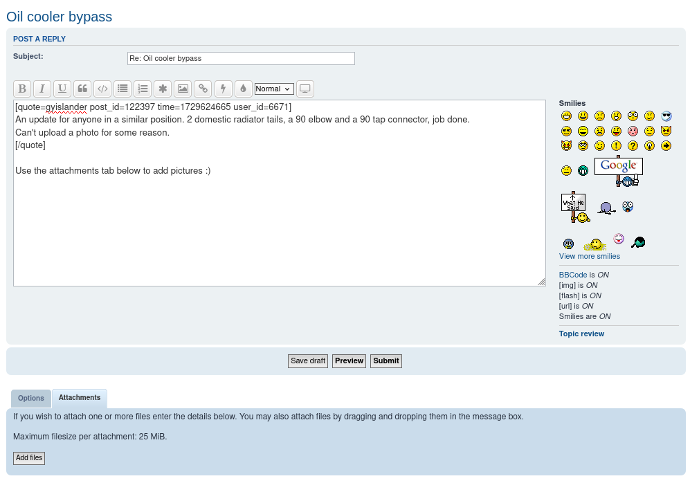

Use the attachments tab below to add pictures :)

Every time I try I get a message saying can't complete due to low memory!

I'm curious now. Can you email me the photos please? dave.g.smith@gmail.com

You got the image upload working :)
