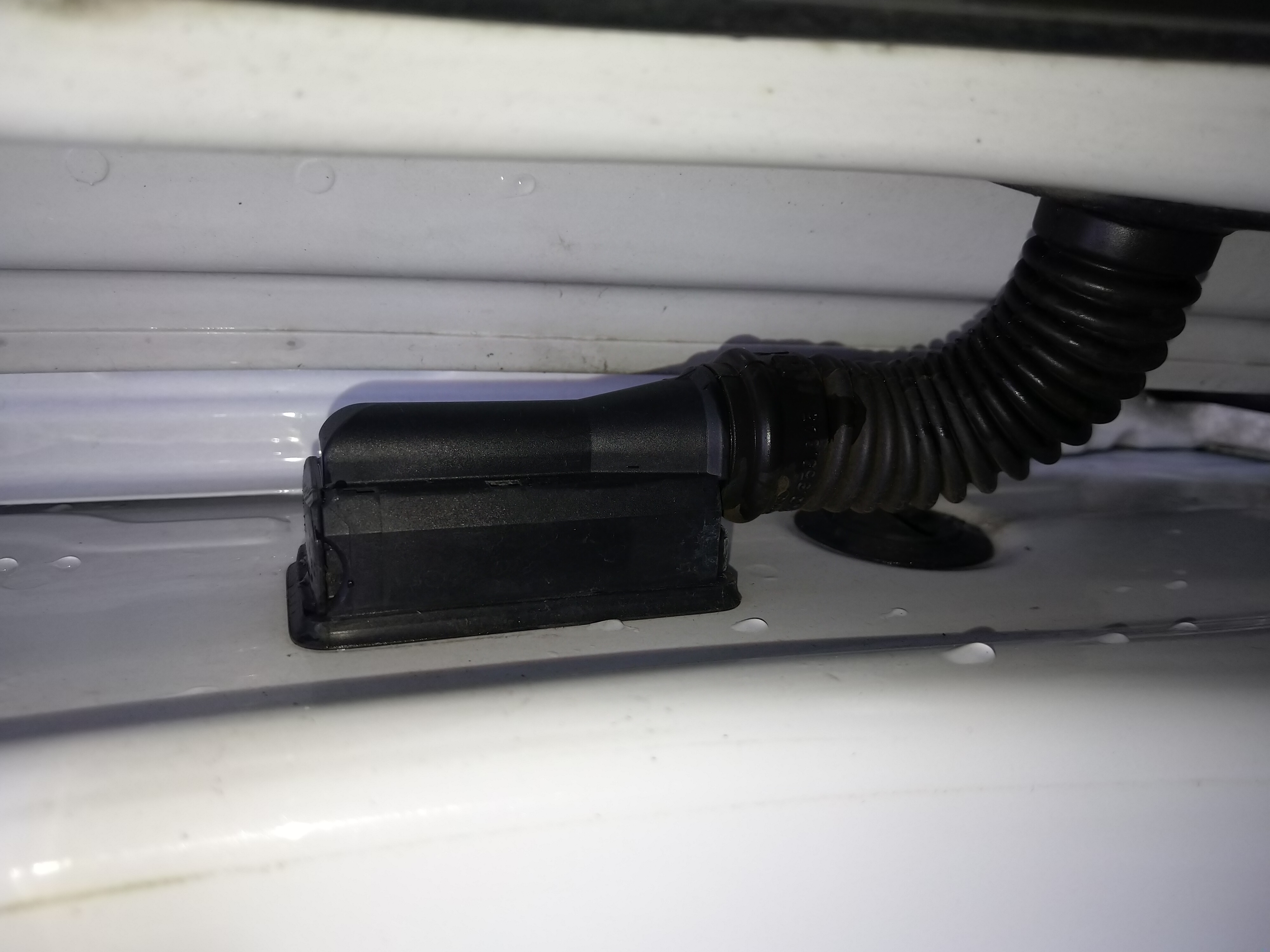

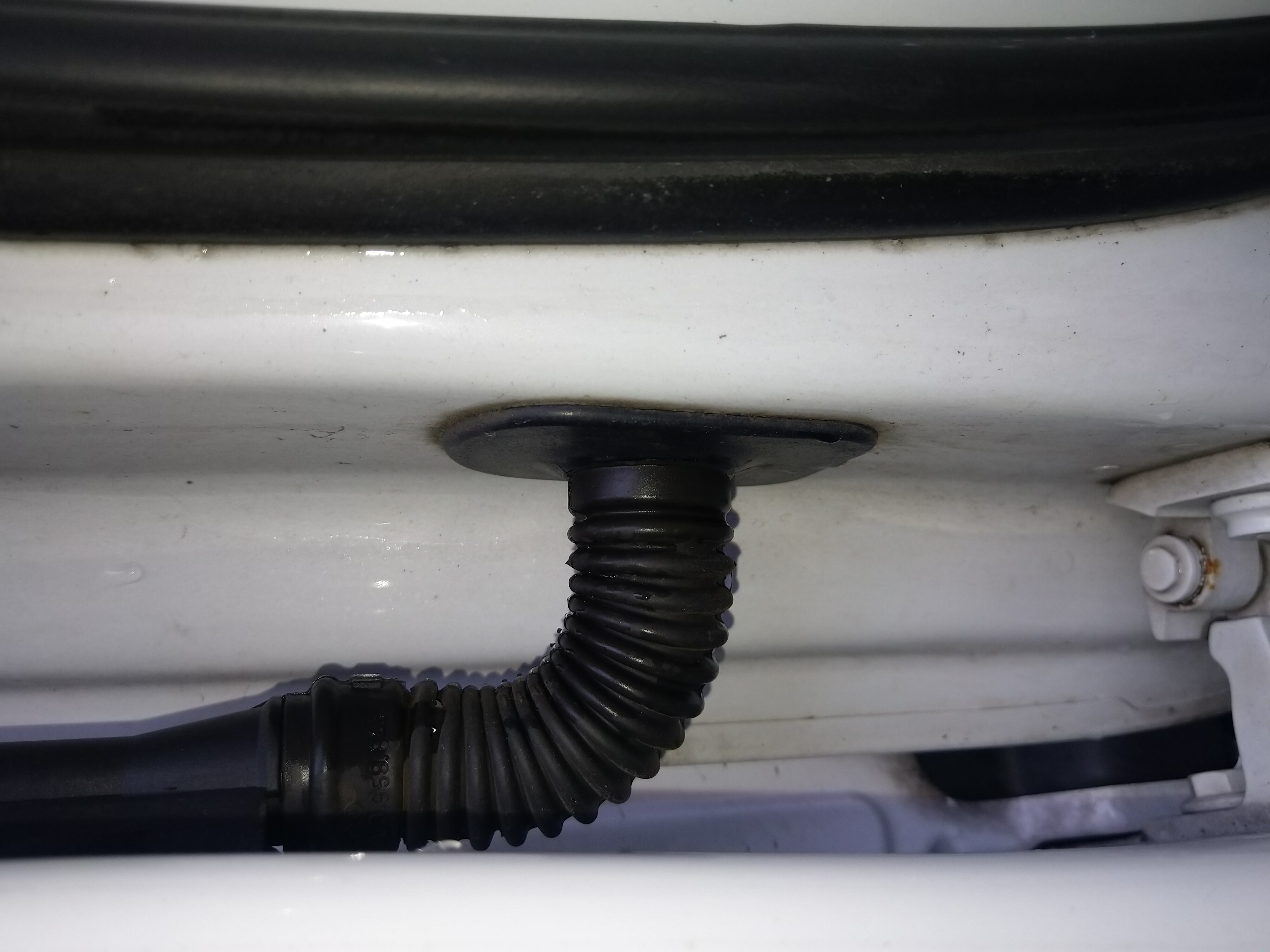

by stevieturbo
DaveEFI wrote: Thu Sep 16, 2021 3:02 pm The other problem is the SD1 uses the older thick insulation wire. And the driver's door contains controls for all 4 windows, central locking controller, door mirrors, speaker and light. So quite a thick bunch of cables.
Even sitting in my dads golf earlier today, the drivers door does have a decent sized conduit.
It's like the VW one I linked on ebay. Chassis side is a rectangular hole in the car with the rubber pointing down, and then over to the door.
Although without cutting a new hole in the car for it, maybe not a perfect solution unless that side could be bonded in some way

by stevieturbo
VW/Audi door ( drivers )
Re: Door wiring
Posted: Fri Sep 17, 2021 2:51 pm
by stevieturbo
Oh FFS they're sideways.
left is top
