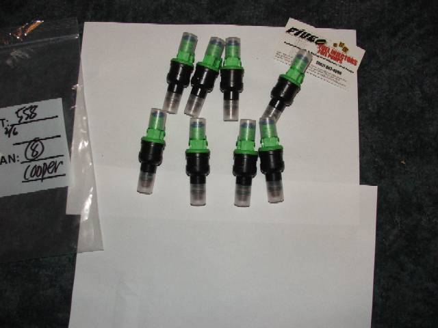

got home from work to a nice parcel from the states,
i am now the owner of a set of bosch green injectors,

they came from www.fiveomotorsport.com if anyone is interested.
