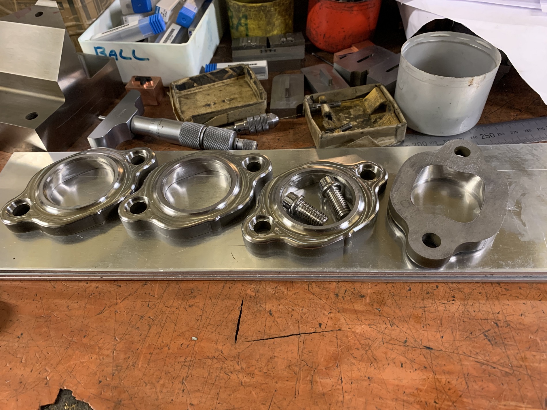

After struggling with making headers for the last engine I cheated and had the whole system made by a lad local to me who is much better at this sort of thing, all I did was make the flanges to match my cylinder heads at work.
