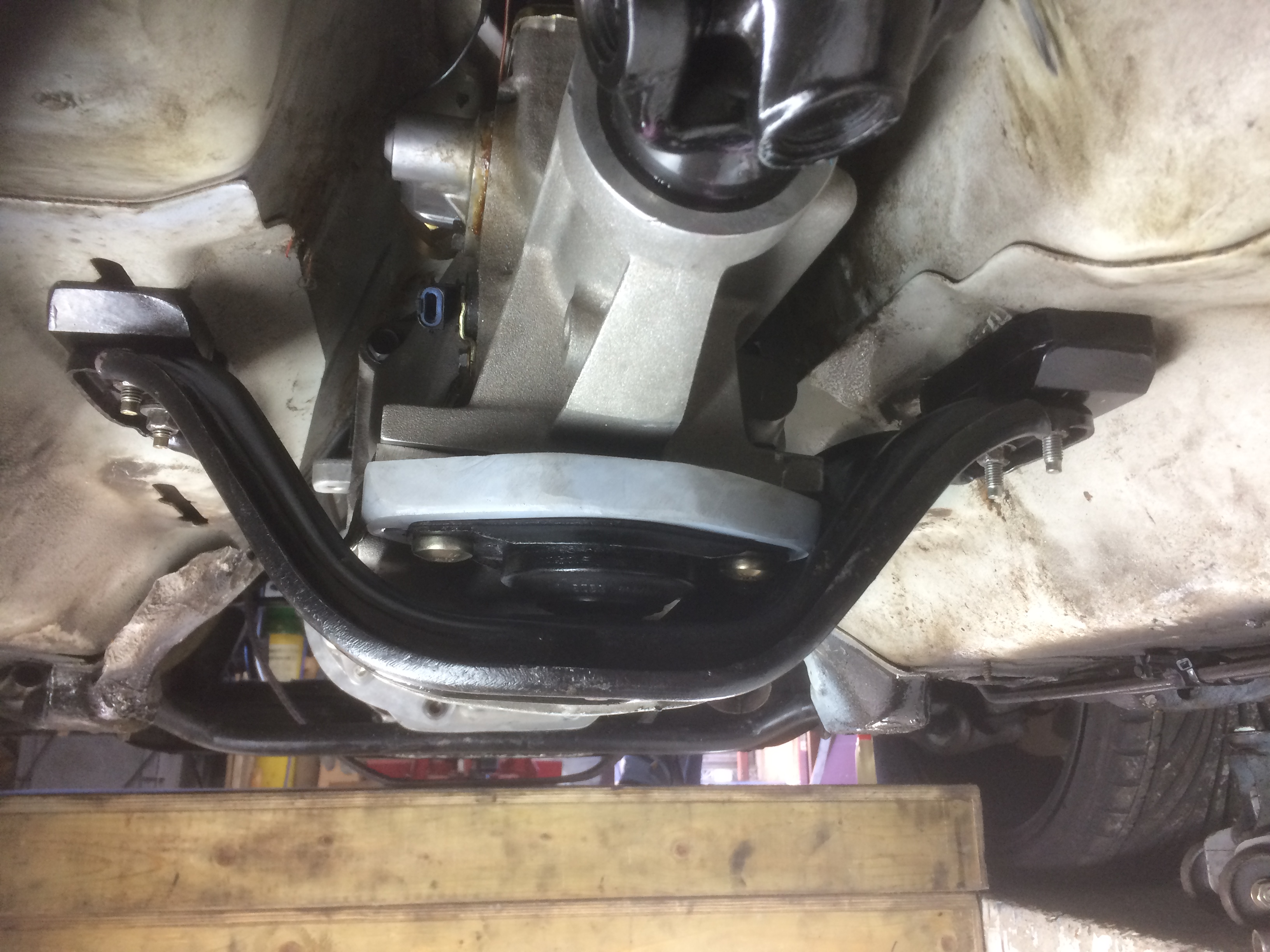

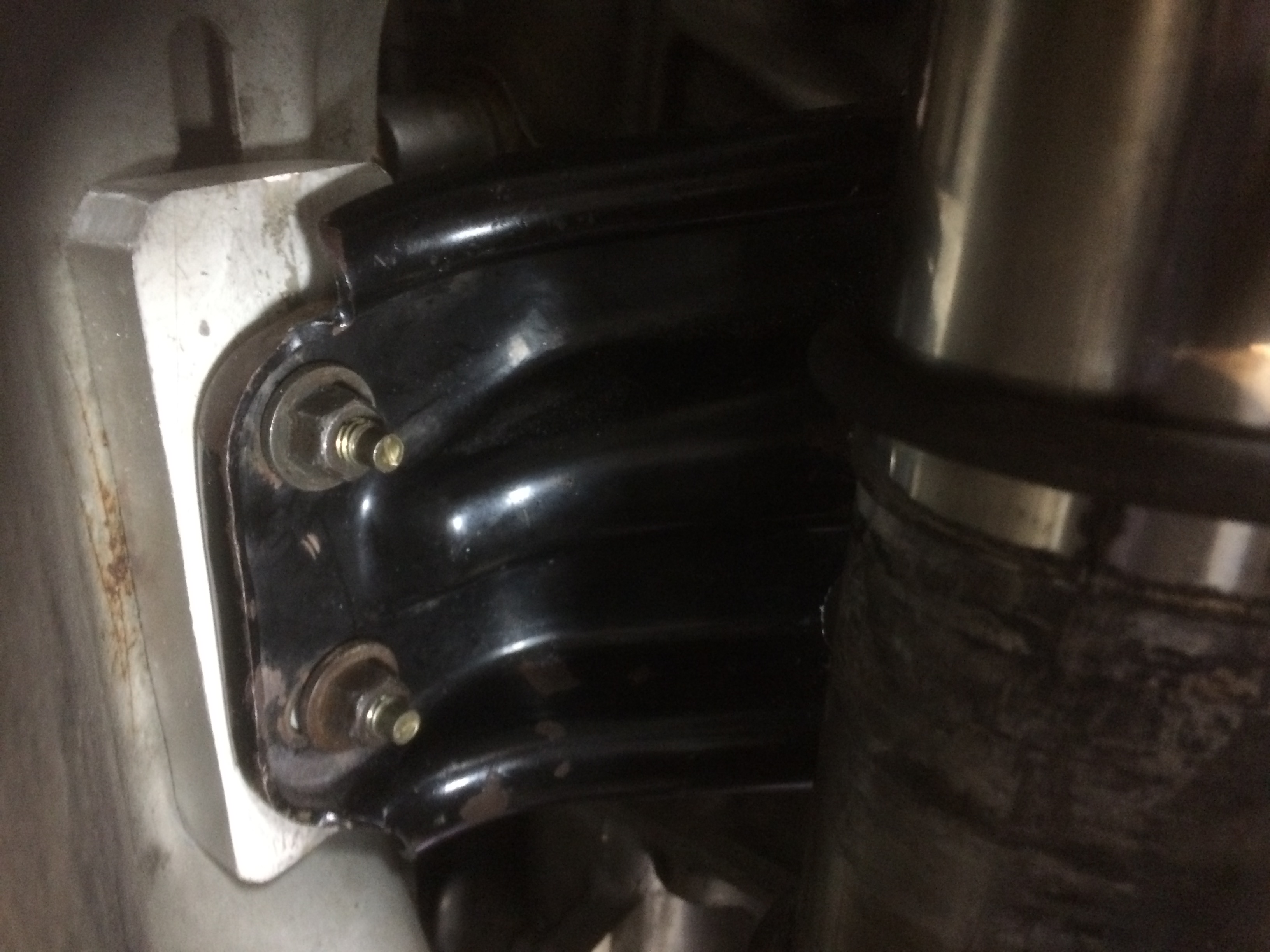

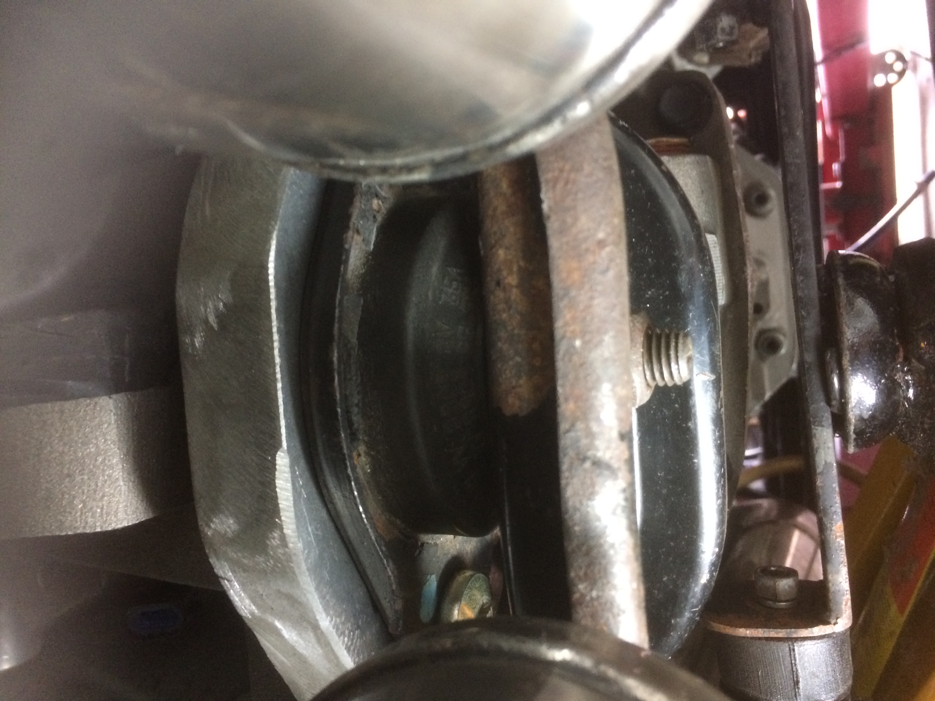

Yesterday I sorted out the gearbox support. I used a sierra
4x4 steel mount and spaced it down from the standard floor floor slots with aluminium blocks. I made new inserts with longer bolts to slot into the rearmost factory floor slots. As the gearbox mounting surface is at an angle I bolted a tapered ali block to it to get things level and inserted a standard 4x4 mount rubber into that. The plan is to probably get a poly mount which will be more compact and neater. The 4x4 cradle needed a bit of grinding out in places and local restrengthening to clear the gearbox casing but only because I needed it to be as far forward as possible to minimise re-positioning work on the exhaust. In hind sight shifting the exhaust boxes rearwards would have been easier.

Engine and T56 now going back in and a few hours left now to get everything back on it. Roll on Monday. We previously modified the clutch to hydraulic operation so a slave cylinder has been grafted onto the gearbox to push the clutch arm forwards.
[attachment
=2]IMG_4661.JPG[/attachment]
