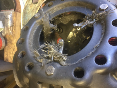

This is what happened to my organic clutch
5.0L ,TA headed, 6:71 supercharged, roller cammed goodness
