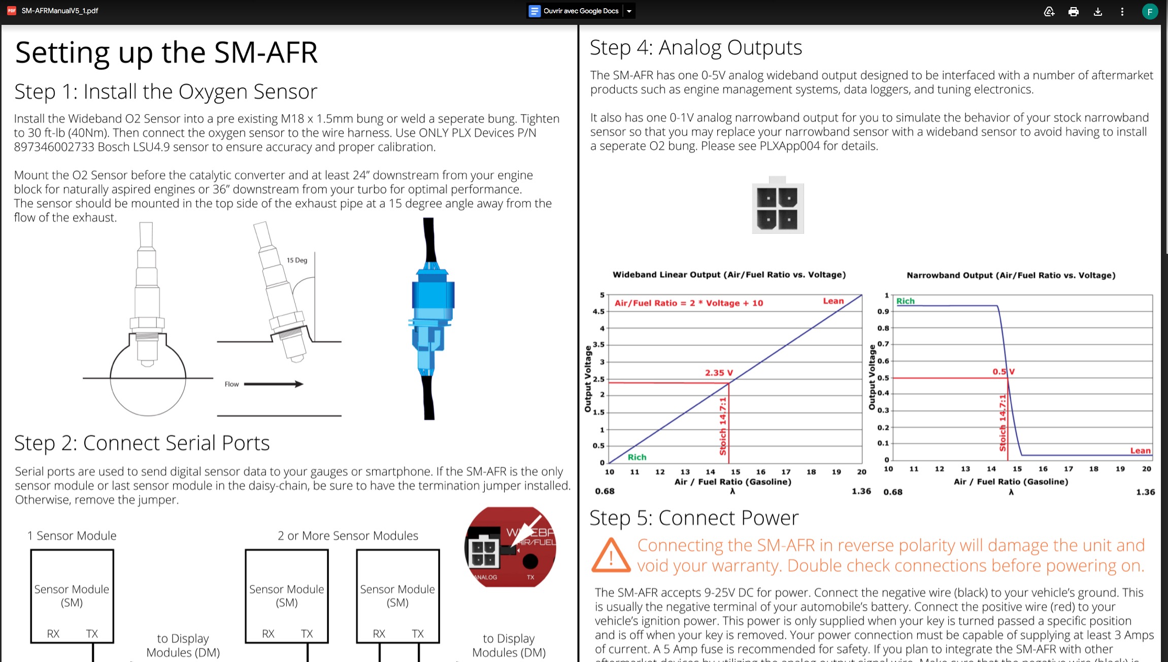

So now the narrow lambda problem is solved as you have on the market wide band with narrow output :
Posts: 424
Re: Adding Lambda probes to Lucas 14CUX on non-cat car
Are you going to proceed with the modification? Presumably you will be fitting 2 of these sensors?
Seems like a significant amount of work and expense, would it not be cheaper/easier to simply fit the OEM sensors for a 14CUX equipped vehicle?
