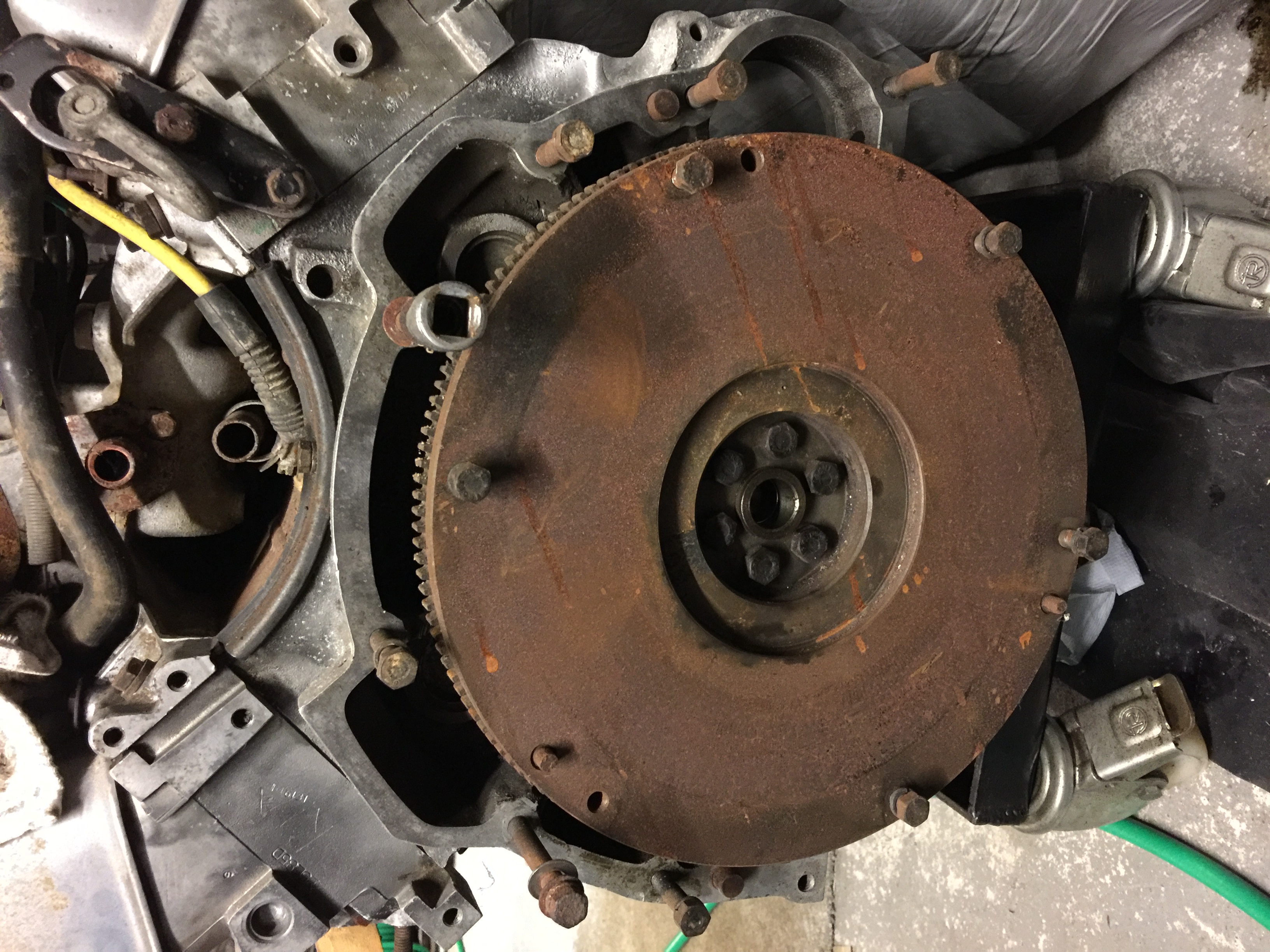

Hello there, this is my first post, I’ve added an image of the flywheel on my Rover V8 SD1 engine. The flywheel obviously needs skimming but when I compared it to my new cover plate the clutch mounting bolt PCD is 260mm but the flywheel PCD is 306mm. Can anyone recognise the the flywheel in the attached image?
Regards, Kelvin.
Re: Forum Members, Who Are You????
I could be mistaken but that looks like a 4x4 10.5" clutch flywheel?
Yeah I'd go for it being the 4x4 flywheel.
