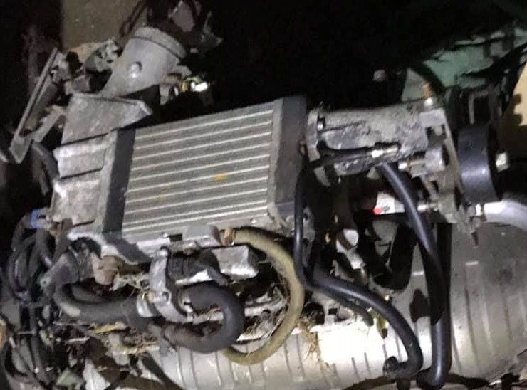

Hi All,
Today I have finally ticked something off my bucket list and after years of searching have bought a complete opcon autorotor supercharger kit with everything needed to rebuild onto my 3.9 / 3.5 4CU EFI HYBRID setup. I believe it has come from a Range Rover and it is a proper engineered piece of kit.
I have never played with superchargers so am after some advice on the best way to run this type of blower? I am planing on using the standard EFI system as it looks to be set up for it.
It is currently still bolted a inlet manifold and has a proper cast interface plate which replaces the trumpet base. Most of it is self explanatory but there is a few things I am not 100% sure about.
The front gear housing has 2 threaded ports is this for a remote oil reservoir? is it needed or can they be run as a sealed unit?
The front nose has a threaded pipe which looks like some sort of breather? not sure????
I plan to completely strip the whole thing and rebuild it with new bearings seals etc, any pointers, manuals etc out there. Unfortunately there are no model numbers on the blower so am struggling to identify what model it is.
[attachment=0]Supercharger.jpg[/attachment]
Any help appreciated.

Interesting project, do you have any better photos?
Did it come with a re-programmed 14CU ECU?
What pulley did it come with and what boost should it deliver?

Here are some pics so far.
Its actually a 4CU EFI System and the only part missing is the ECU.... So not sure what to do there, someone must have a old 4CU Adjustable ECU laying about somewhere which I could purchase?????
Pulley wise... It has a 65mm pulley on the super charger. Not sure what sort of boost it will deliver but I am not really looking to go mad.
I have never played with superchargers / blowers before so its very much all a unknown.
Any help, guidance, tips or hints would be gratefully received

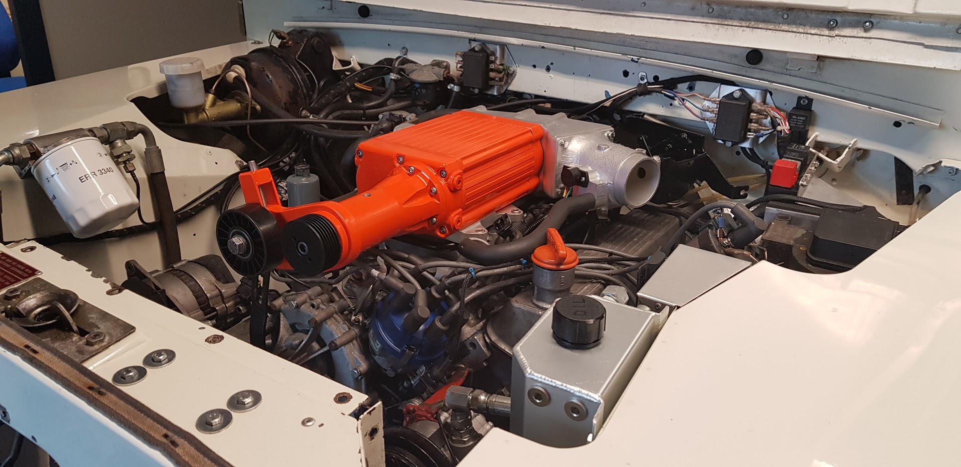

Supercharger is running poly V belt but am leaving the rest of my engine on std V belt.
My little S2A is allready heavily modified. LT95 HD Gearbox, Stage one V8 Axles and big brakes... Might need to upgrade to discs but will see.
This is my current set up.... Cant wait to get the supercharger finished and bolted on!
Thanks for the help

Looks nice and tidy engine day.
One of my biggest headaches with my supercharger install was getting the belt system sorted.
How do your pulleys line up? I think I would have a measure up and see roughly where the supercharger pulley lines up - and if that interferes with your current V belt setup?
If your supercharger pulley is inline with your V belt you might have an issue?
Have you thought about fitting a serp timing cover and using one serp belt? don't know if that was the setup the previous engine used? (then maybe you can find a serp front cover which happens to have a 4.6 bolted to it :D )
Tom.

Original kit had a belt driving crank to waterpump to supercharger via a tensioner.
Done a bit of measuring up and I think??? The pulley will clear all the V belts Might have to machine up a spacer to stand the supercharger nose pulley a little.
Really don't want to swap the front cover as it will upset my hydraulic winch pump install as well.
Sure it will be fine :)

Hi All,
Finally got round to getting my blower kit installation underway
Got to wait for my new Radiator and to finish machining some custom pulleys but almost ready to start it for the first time :)
I have had a custom ECU and AFM done by Mark Adams of Tornado systems where he has put a basic map onto it so this should run straight out the box but where do people set there ignition timing to? Normally I would run at 8 deg BTDC but I think I might need to retard this a bit so open to some advice on that one.
