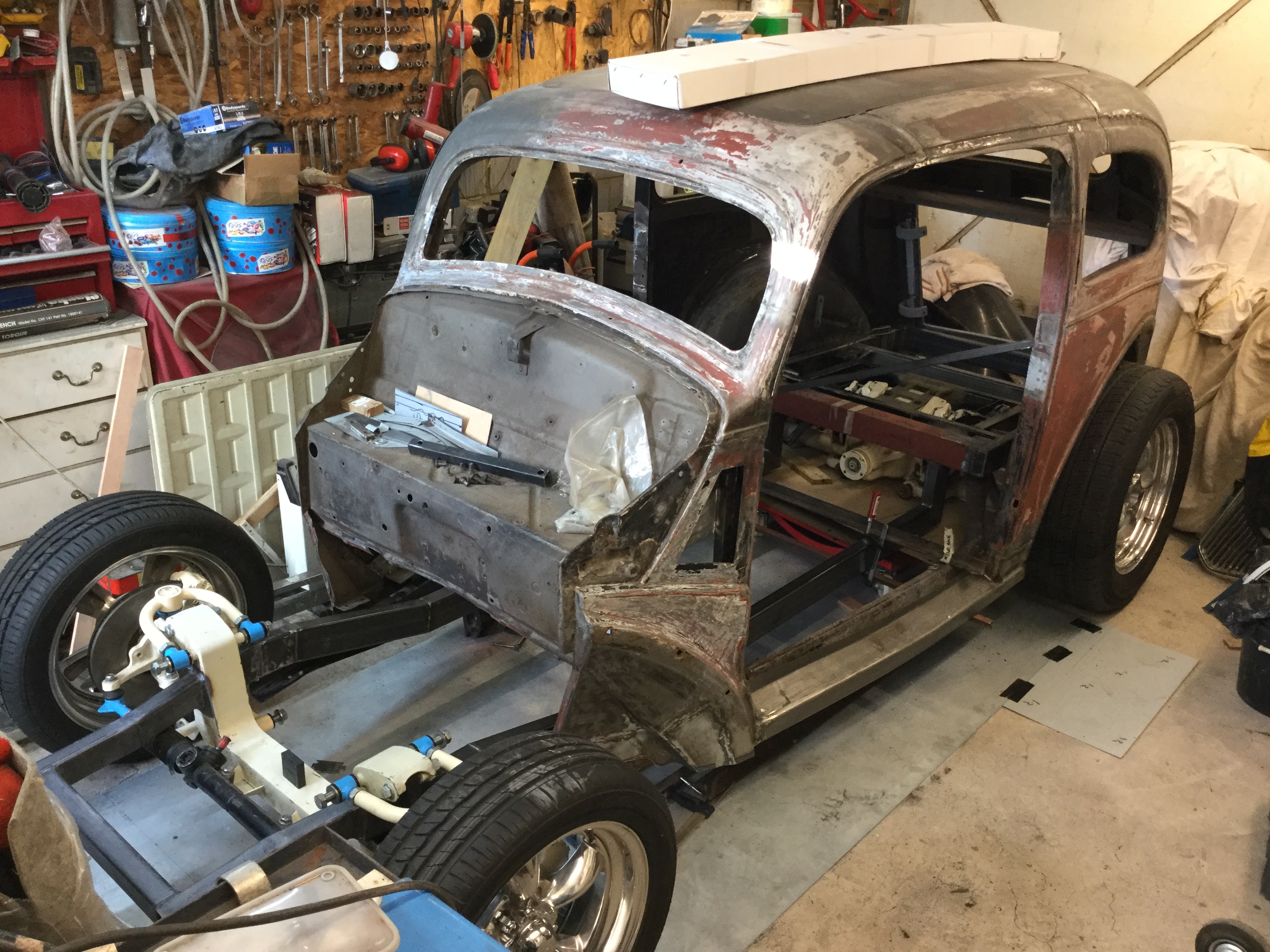

I have a 1959 ford popular (sit up and beg) which was originally going to be fitted with a V6 cosworth. Things are making me reconsider.
Range Rover 4.6 auto is now one option, but I need to use the gearbox for licensing reasons. Question is how to make it 2wd, and wheter it's possible
Chassis made, body just about sorted, back end Jag IRS, engine gearbox next.

Thank you DaveEFI, I was wondering if a tail shaft switch was possible, is it a casing switch or just remove the transfer box and fit a tail end from a jag or similar.
Thanks again.
![Image](%5Battachment=0%5D89A00ED1-9B3F-4C53-80A7-3378C8644DC5.jpeg%5B/attachment%5D)
![Image](%5Battachment=1%5DBE67FE0A-EABF-46E5-B0FC-F8785ECBDBB4.jpeg%5B/attachment%5D)
