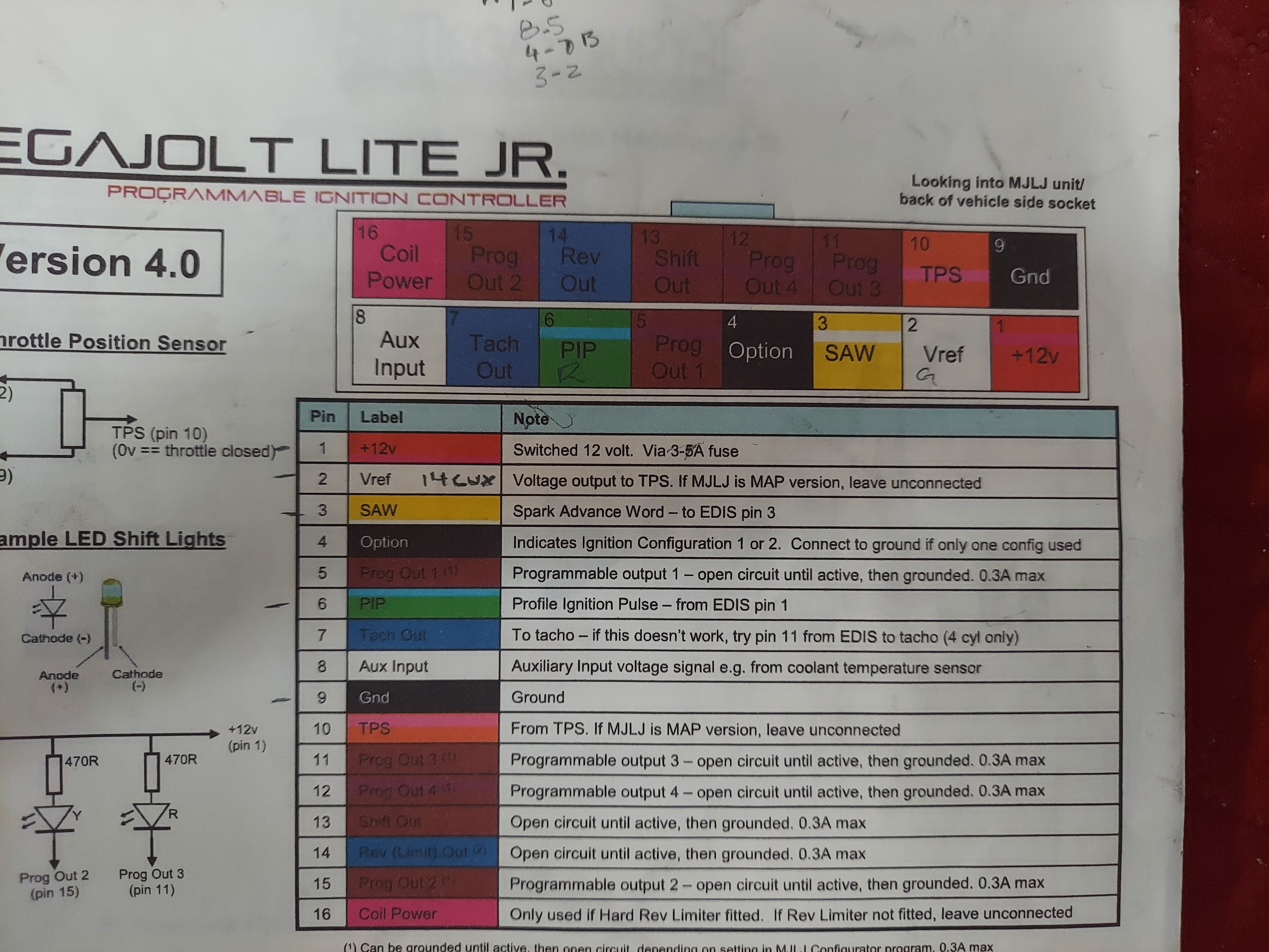

Hi to all, I have a 95 Range Rover it runs a 4.6 rover V8 engine and 14 cux EFI. around november 2020, I retrofitted the distributor with EDIS from trigger wheels. all in all the install was easy and somewhat involved. completed in about a day.
I powered and loaded the megajolt "E" with rover V8 software, had a bit of difficulty reconfiguring firing diagram but eventually figured it out.
the road test went fine, engine seems to have good power. I went to overtake a lorry and engine fell flat at 4000 rpm. further review showed I had the megajolt configured for MAP and not TPS. once reconfigured, the engine revved fleely to 6000 RPM.
thru all of this testing I found that as I accelerate from idle, the engine will stumble briefly and then revs normal. this is bothersome as when I stop for any reason and attempt to proceed it gives the impression of cutting off.
if I disconnect the megajolt controller engine revs normal, I plugged my laptop in order to review settings. all looks normal, rover v8 normal aspirated, TPS.
When I attempt to calibrate TPS, I found the TPS gauge display is pegged to 100%. when I cycle the power (ignition key) the gauge will start at Zero, do a complete 180 degree sweep and then back to 100%.
does not calibrate, it will go thru the step of "ensure TPS is at rest" tap next "ensure TPS is at full throtle" I press throtle, tap next and PC displays "rest and full throtle cannot be equal values of 225".
I have attempted this at any throtle position with same results.
I have checked timing advance with timing light, timing does advance upon throtle up. megajolt is wired to SAW pin 3 from edis pin 3, PIP pin 6 from edis pin1, 12 volt pin 1, ground pin 9 and TPS at pin 10 from 14 cux pin # 20.
what am I missing?, what mistake Am I making? why is my TPS read out on laptop pegged at 100%? why does my throtle falter when Megajolt is connected? why does it not allow me to calibrate TPS on laptop?
Any and all suggestions are welcome and greatly appreciated.

Ok lads, I have resolved my situation.
turns out to be it was a blunder when I wired the MJ/E, for some reason, I misread the pin location of pin 2 and pin 10. according to instructions (and my personal notes during install), pin #10 is to be used if using TPS. TPS signal on 14CUX is taken from pin 20. pin #2 on MJ4 is listed as Vref or voltage reference to TPS, "if MJ4 is map, leave unconnected". well further reading states or asumes that ML4 is being used in conjunction with Mega Squirt, thus MJ4 would supply reference to Mega Squirt TPS. basically I was back feeding voltage to 14CUX TPS thru its signal wire.
