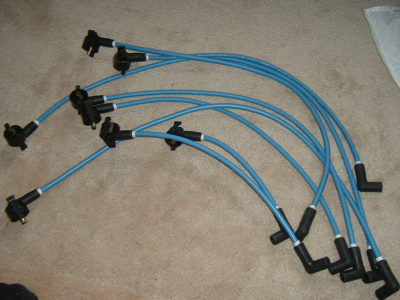

I'm using cheap ass leads I bought off ebay that had the spark plug ends I wanted. Then just cut the coil end and crimped a new bit on.
People can get over worked up about leads....as long as they dont leak and the ignition system is good...really nothing fancy is needed.
Think they were intended for a Ford Explorer or something
Actually bought a couple of sets ( as they were intended for a 6cyl, and I needed 8 lol )
Not sure how they'd suit a Rover, but probably wouldnt be too bad

Since I have EDIS on an RV8, I made my own to get the correct lengths. Being a cheapskate, bought used EDIS leads for the connectors and new cable. I have quite a selection of crimp tools and looked to see if I had one which would do, and ended up using a BNC (video/data coax) one, which produces a hexagonal crimp. These are a common tool, so cheaper than custom made ones. leads have been fine for several years.

I've had all mine custom made up by Fastlane Automotive, who are now know as FLA manufacturing.
http://www.fla-manufacturing.com/products/index
They still make leads for individuals, just tell them what lengths you want, the edis cap type, what plug end you want and any special things like heat sleeving or numbering.
They use decent spiral cored cable without paying the stupid magnecor / mallory tax. You have to remember that EDIS packs deliver a decent fat spark and dont really need high end leads.
